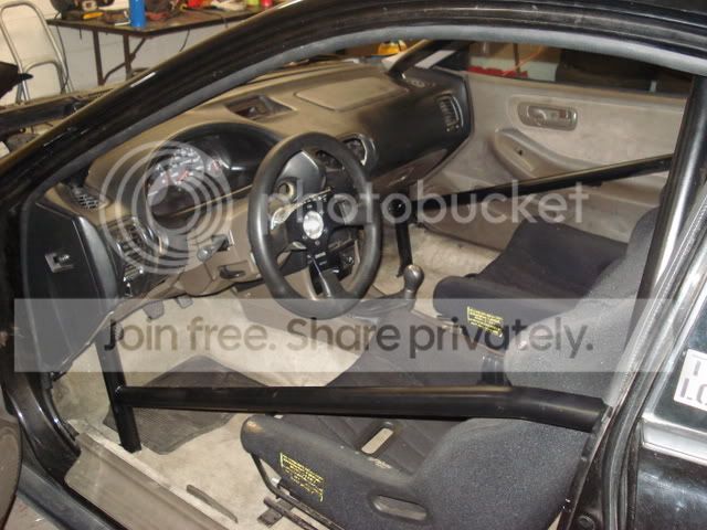

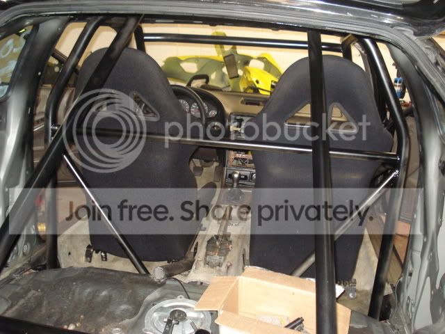

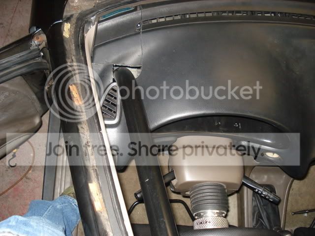

I'd be really upset if that were my car....
F'ed up rear bumper....
Door bars are crazy high....
Dash is all tore up.... (I don't think that will pass NJ inspection with a cut up vin area)
this was a Kens Kustom kit too right? I know for a fact that you can get the A-pillar bars tighter to the car then that with their kit in a teg....

Actually, the fact of the matter Rob, is that your car does not qualify as a collector car.... so you can throw that out the window.
I know of more than 5 cars from the top of my head that are street legal, meet all dot regs, and place rather well in SFWD.
There is no need to get all defensive over this. You have to admit that the cage came out rather hacked and it looks like they put it in quickly.

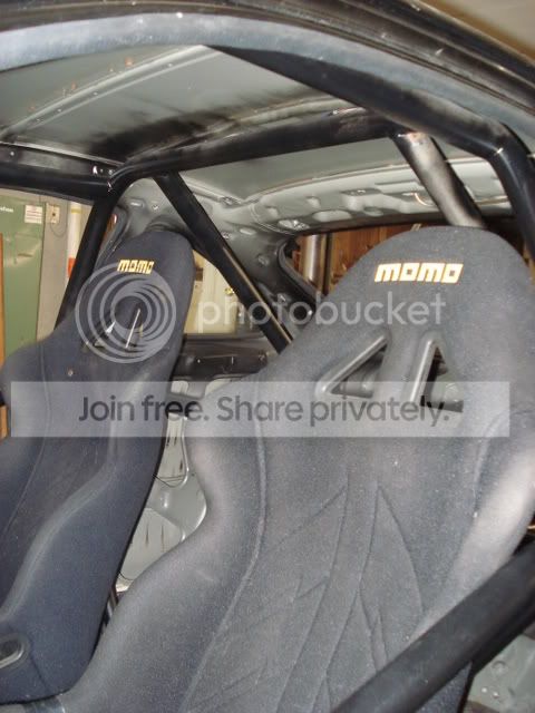

With what sanctioning body are you driving? The side bars are not NASA or SCCA compliant. Properly padded, I think you might be able to drive in Solo 2 or NASA HPDE (depending on how Tech enforces the CCR in your region), but I don't think you could race w/that particular cage.
Is it a drag racer?
If the Momo seats do not have an FIA number on them, you will need back braces on both seats.

When you get fast enough that people are telling you to cage your track car, the looks of the interior have to go out the window. Hell, if you're not very specific about it, you'll probably even lose the VIN plate on the window!
For whatever it's worth, his dash looks better than mine. My car is at the very edge of what the state police will allow in Virginia. It's hard to have a fully caged car that's on the street. It's really not the safest thing to be doing.

You'd better read your club's CCR to be sure. In NASA, if the seat is not FIA, you would need a back brace even if you are just in HPDE.
I won't go into gory details, but Jim Politi has this weird scenario that ends up pushing you back under the harness bar in a non-FIA seat.
Yuck.
Knowing that you're drag racing and not circuit driving basically answers most of the concerns I had about the cage.

Around here, if you start cutting up the vin area, you're basically asking for you car to get towed. That's my main concern... and if it takes an hour of extra work to make the dashboard look a little cleaner than I'm willing to do it.
I've tried to keep my car as street-legal-as-possible so far but any signs of tire rub, missing or altered emissions equipment or funky business with the VIN and my ride remains "street legal" by honda-tech standards but not by provincial standards.
This is now OT but I'm wondering if it's possible to install the dashboard while cutting in from the sides. Maybe even have the bars go through where the vents are (on a CRX) while still following all the rules. I could swear I've seen it in a magazine.

Around here, if you start cutting up the vin area, you're basically asking for you car to get towed. That's my main concern... and if it takes an hour of extra work to make the dashboard look a little cleaner than I'm willing to do it.</TD></TR></TABLE>
The same rules apply here in the states too.
What boggles me is that they pulled the front windshield to do this install. They could have mocked up the cage fitment with the dash out (taking measurements), cut holes in the dash (with a hole saw and using those good measurements), reinstalled the dash, dropped the pillar bars through the open windshield and swung the legs in that go to the main hoop.
That's just how I would have done it though.... what do I know.... I'm not Tony1.
