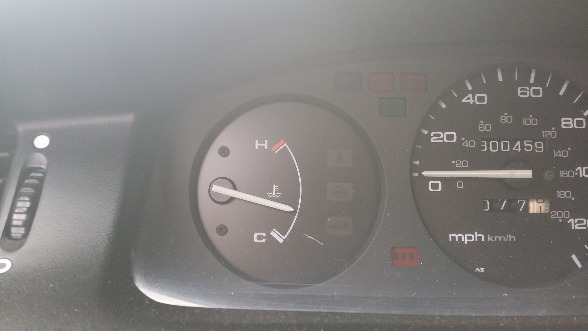

So this is where it was when i got to work. Went past a quater
Does this seem normal?
Just curious

That's what my integra and crv get to when fully warmed up.

That's good. If that needle goes above 3 o'clock you need to get worried.
