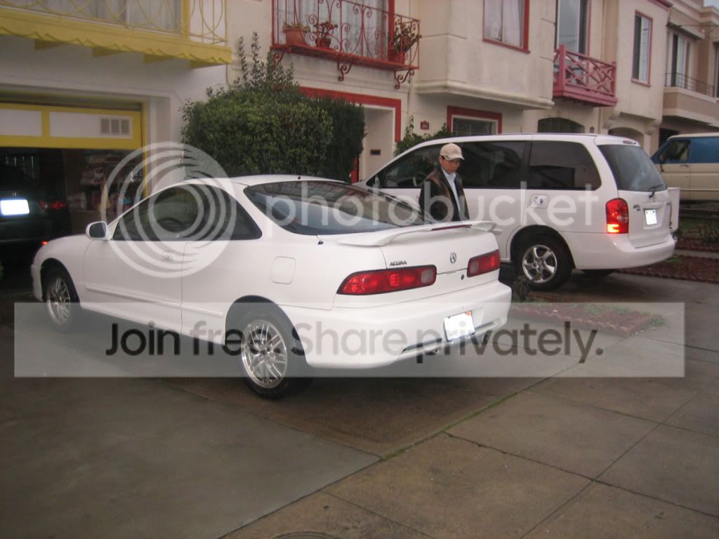

Default where is this leak coming from? picture inside
car is 01 integra 5spd manual.
