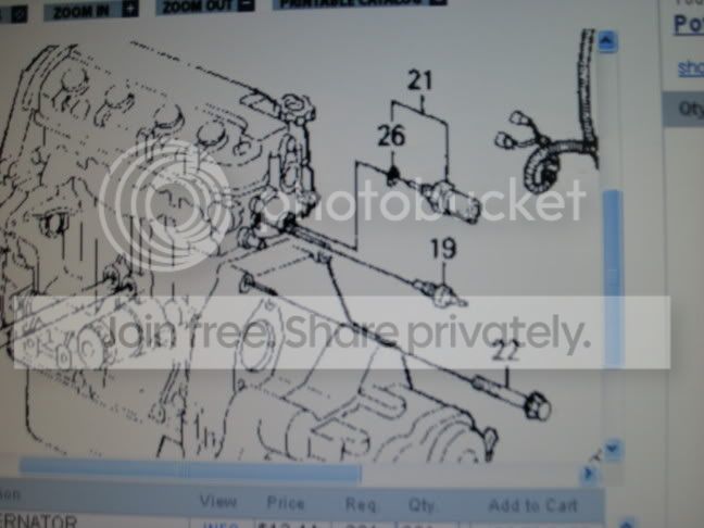

While I was installing my clutch I accidentally stripped the threads on the engine block of my D16A6.
The bolt (size 12x65) that connects the transmission to the block (as pictured numbered 22), is just spinning. So, I was just going to drill it out and tap it a larger size, but I was wondering if anyone knows what size I should use.

check out m12x1.25....thats the thread pitch of the bolt that secures the engine and tranny together.
Why not just buy the correct tap kit with the size I listed and try to slightly re-tap the threads? you might be able to correct them.
if not then try to re-drill with a larger diameter bolt and re-thread it(but not too large as it might weaken the mounting area
