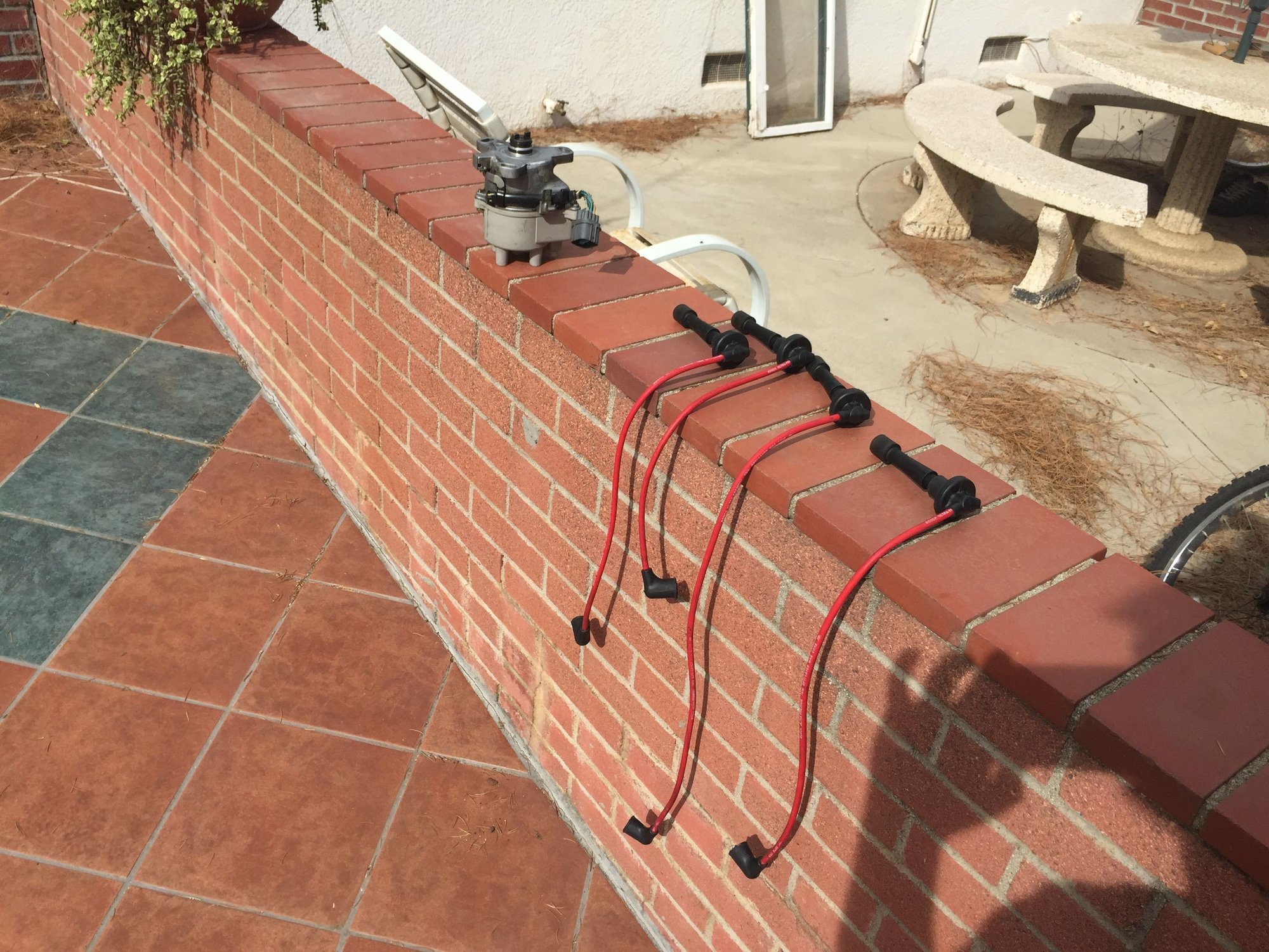

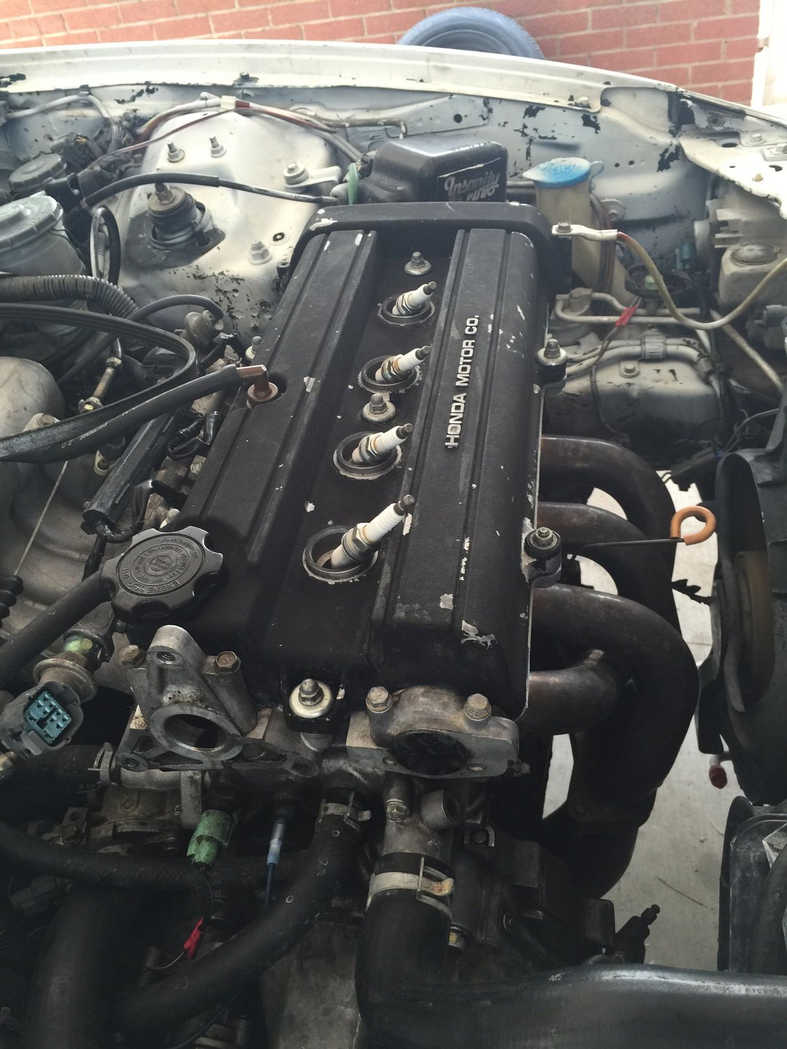

Ok well I pulled the distributer and wires and have them sitting in the sun and I pulled the spark plugs
Sprayed brake cleaner in the bottom of the sockets to try and evaporate any moisture in the bottom got new plugs
