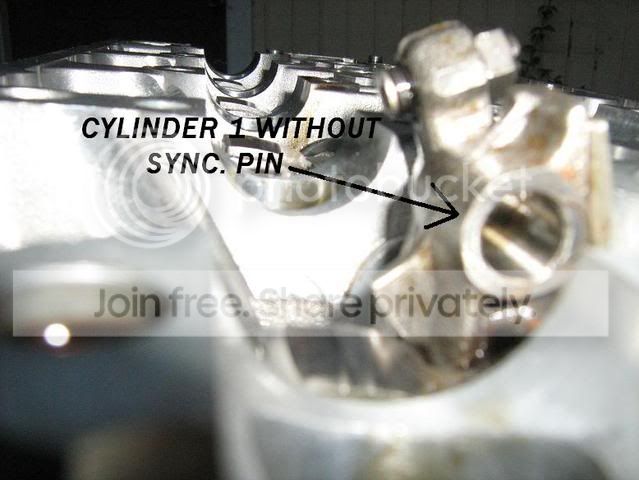

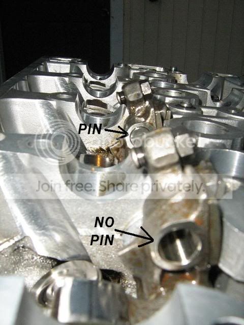

OK, I know its kind of a shot in the dark, but I was hoping someone might know.
Heres the story. I have a new head thats been sittin around for a while, and I am finally getting around to buttoning it all up and getting the new motor together. Thing is, the previous owner dropped a valve, and ended up having to fix/replace a lot of things. The head looks great, no damage or anything, but apparently it was not re-assembled correctly and some things were left out.
Cylinder one, intake side. The center (VTEC) rocker arm syncronizer pin was completely out. I put it back in, but it fits rather loosely. Is this normal or should it be pretty snug in there. Also, on the outermost rocker arm, also cyl.1, closest to the dizzy, the syncronizer pin (which i believe also has a spring) is missing. Nowhere to be found. Can I replace this, or should I just replace all of the rockers on the intake side of cyl.1? All of the others look practically brand new and intact.
Any help would be greatly appreciated.

V-tec rocker arms are supposed to be replaced as a set (per cylinder) because the bore for the synchronizing pin is align honed as a set. However, since you only need to replace the pins, and not the arms themselves, I see no problem with simply adding in the missing pins. As long as they slide smoothly in the bore, it should be fine. Worst case scenario is that vtec won't engage on that cylinder, but if you're paranoid, you can always test that with the head off the car by hooking up an air compressor to the head to simulate vtec. The compressed air will lock the arms together, and you can manually turn the cam with a ratchet to make sure vtec is functioning on all cylinders.
But that's a pain. I say just throw in some new pins and be done. And I don't know what you consider "loose", but the pins will normally fall out of the rockers if you tilt the rocker sideways. They don't have a tight fit or anything. The friction from the motor oil that surrounds the pins is all that holds them in place when you assemble the head.

The BVTEC heads dont use a spring mechanism.
No you cannott buy pins from the dealer. Give me your address.

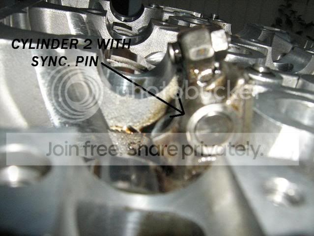

Correction. I looked at it again and it is actually the middle pin that is missing. Apparently someone had moved the one from the far side into the middle, which was apparent once i saw the size difference.
These pics should help a bit.
