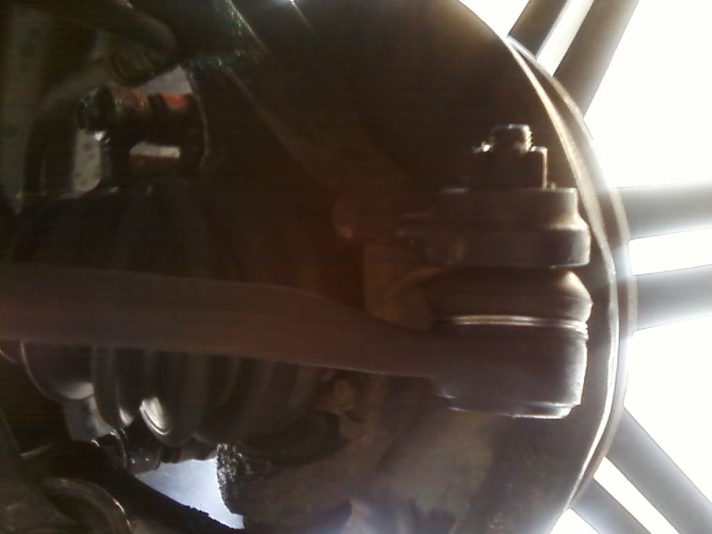

Hi guys my problem is after front passenger side axle,spindle,hub bearing and tie rod replacement.I just realized that my passenger side front wheel got some turquoise blue grease spread inside of the wheel.I just quick-looked to the axle without lifting the car it seems good.I don't know where did the grease come from.Please let me know if you guys have any clue what i am talking about.??

looks like axle grease to me. It might be seeping out of a tiny hole in your boot, or there could be some leftover under the boot clamp. Wipe it all clean, drive it, and check again. If it comes back as much as it did again, you probably have a hole in the boot as I mentioned.

I have already cleaned them after i took the pics.Lets will see what is gonna happen later.thanks

looks like your boot may be leaking. I agree with the clean it and check again.

that grease is only gonna come from inside the boot...

I cleaned it but after couple days it leaked again.when i look at cv boot it seems okay.do you guys think it might come from the strut or something.
