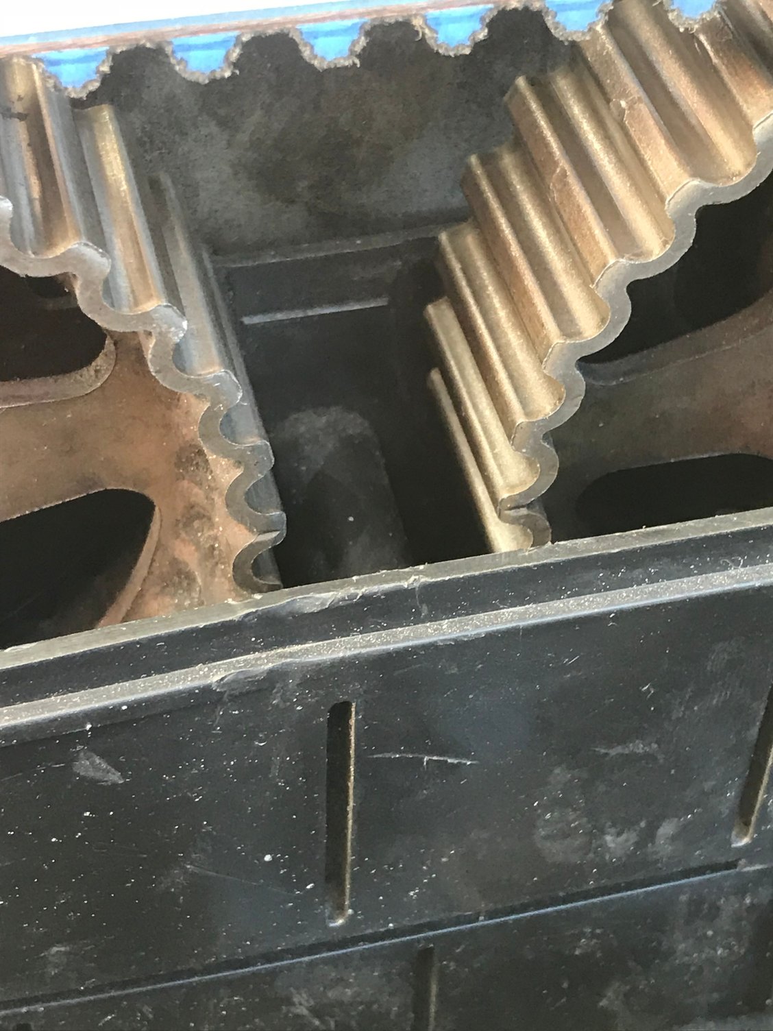

Sorry it’s a 1995 Integra LS
this is timing belt currently

Well, yes and no. If the cams were 180° off, your compression test will still be positive, but there will be no way the engine can run as the spark plug will fire near the end of the exhaust stroke.

You missed my point, if the timing belt was put on with the cams out by 180°, you will still get good compression, but the distributor will fire near the end of the exhaust stroke.

I installed the cams with both arrows pointing upwards on the cam gears and 5mm punch pins through the cam cap holes into the cam holes to lock them. Correct me if I’m wrong but that’s TDC for cams.

shipo, there is no mechanical way to install a set of Honda "B" series camshafts 180' out with all cam and crank markings lining up. Now, if one were to force the offset tabs on the distributor shaft into the cam slots, I suppose you could have incorrect timing events. The easy way for the OP to dispel your concern is simply to align all timing marks to TDC with the cams UP, remove the distributor cap and see if the rotor button is pointing at the #1 position (bottom left when facing the distributor). If it was 180' out, it would be pointing at the #3 (upper right) position.
