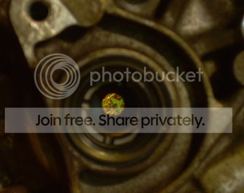

I bought this transmission from a guy in chicago that is a Japanese motor and tranny dealer. It is a b16 tranny with a diff in it that I have never seen before. Take a look and let me know what you think, who knows what kind of diff this is??

I don't think i understand the question but it looks to have LSD.

Looks like a factory LSD.

If it B16 gearing, and a factory diff, you have a Type R trans.

I figured it out somewhat...It is a clutch style lsd but I dont know what brand...not to worried either, it behaves nicely...

Looks like a torsen diff to me, but it's hard to tell in the pics. Kaaz/Cusco aren't fully see through. Neither are OBX/Quaifes because of the washer packs. OEM LSDs are the only ones I know of that have an untapering, straight shot through the center.

hmm, kewl...so you are saying that those are washers in the middle for spacers I guess??

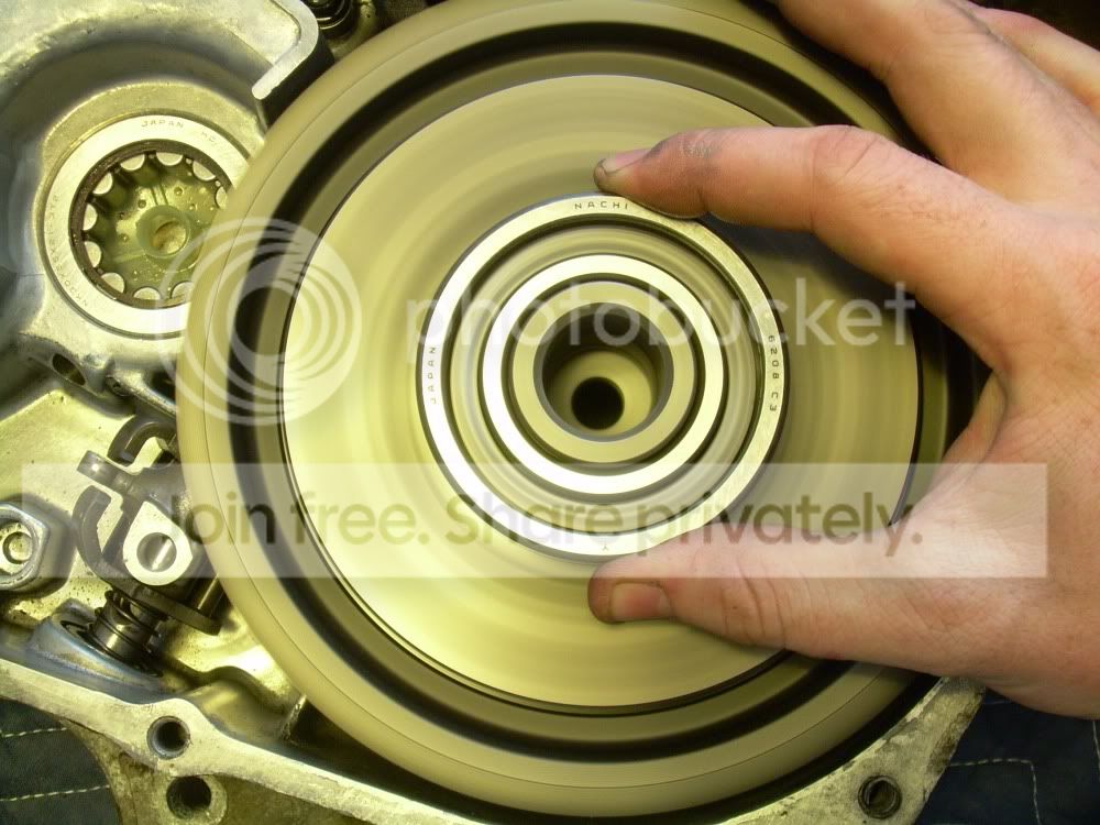

no it's not, it's either a quaife or an obx
here's a quaife

Well like I said, it's hard to tell in the pics - is it a straight shot through the center, or is there a washer pack in the middle? The pictures he posted make it hard to tell. To me, it looks like there is no obstruction in the middle and the hole is the size of the axle splines all the way through the center.

my buddys quaife goes straight through...same size as the axle splines...

He must have an old one, before they started preloading them.

its about 5 yrs old...
