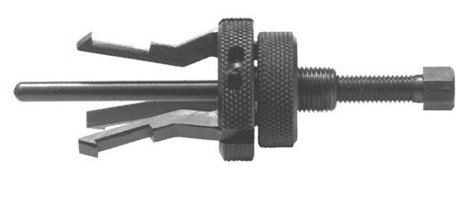

Gearspeed-Performance's Avatar
Join Date: Feb 2004
Location: Rancho Cucamonga, CA
Posts: 5,903
Default Re: (69NOSAJ)
Just get a small bearing puller. You may need to machine the lips a little smaller...it will come in handy! Looks like two little legs awith a lip to grab on the bearing...Looks similar to this but, with a slide hammer section like a dent puller
http://www.samstagsales.com/SirTool/st1090.jpg
