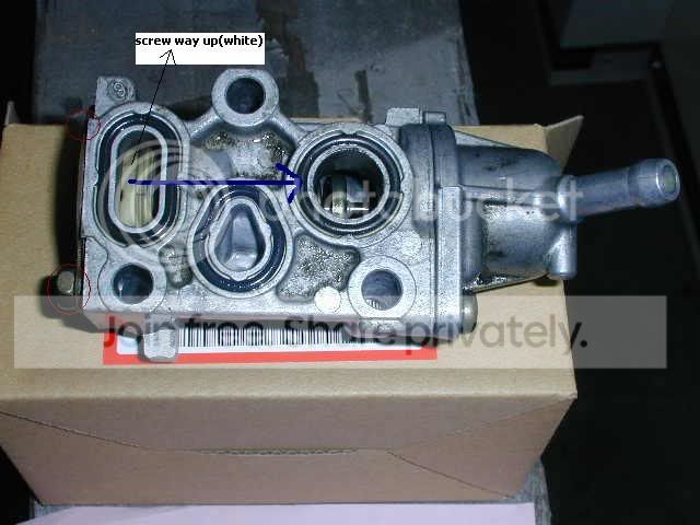

if you notice in your second picture,
the white thingy inside the FITV, that is way too high which cause the high rpm surge. If you take a look at the left, there are two screws there in red, unloosen those and take everything out from in it and clean it with carb cleaner, after that becareful where each part went and tighten up the white thing almost to the bottom facing the blue arrow. Finally cover up the top portion and screw the red bolts back in where it belonged. That shouldve solved your problem and saved you lots of money. This has also been covered pretty well.

^^yes I had a surging idle problem on my b16 too, I took off that little plate cover, and tightened down the plunger with a quarter or a dime.... problem solved, total cost 5-10 mins of my own time and a bit more than that in reading
reading FTW. It can save you lots of money
