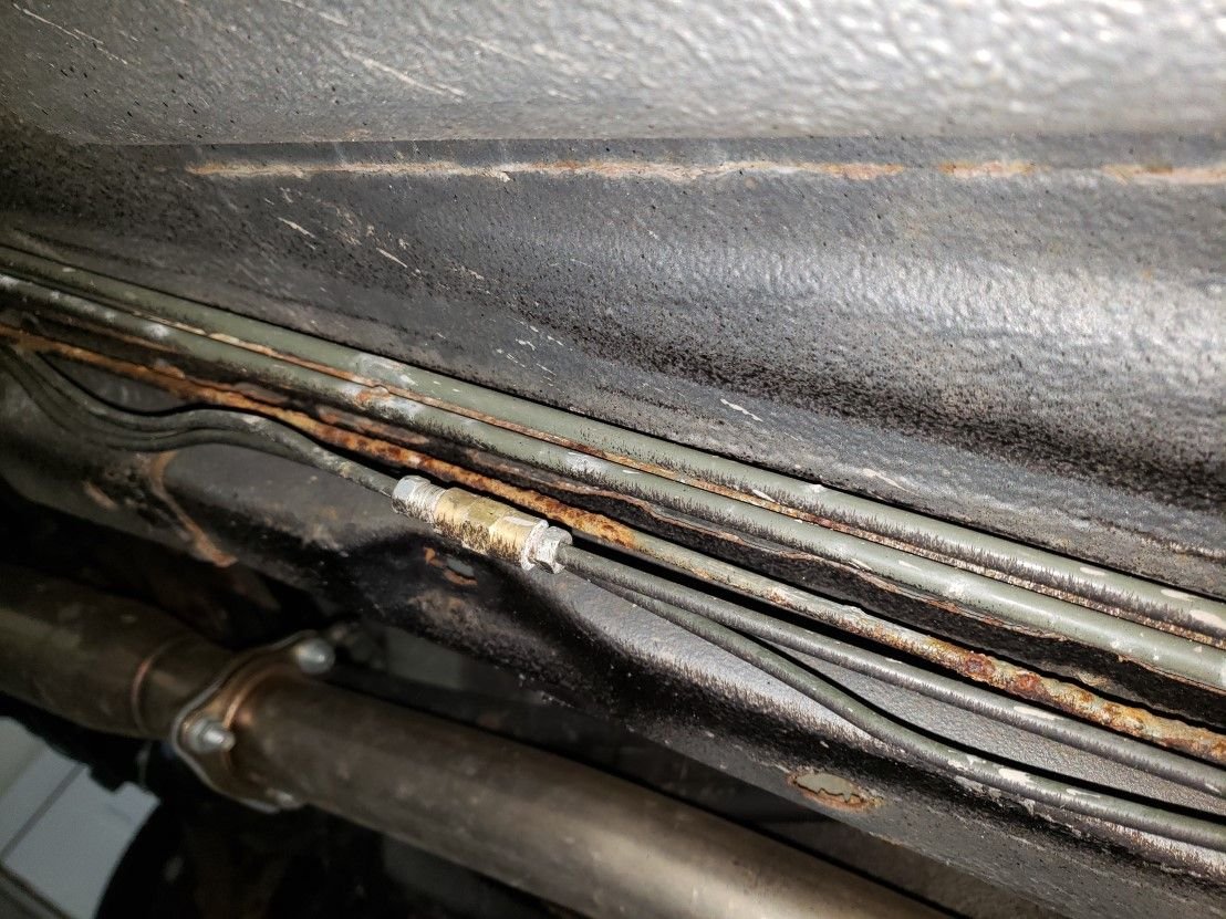

Just bought a 98 Civic DX and looked underneath to see what needs to be addressed. These lines look NASTY! What are they, is there a recommended third party brand/part number and how difficult is it to replace?
Thanks,
Jack

Brake lines. You can buy hose kits from Russell, other manufacturers also have lines you can buy.

Brake lines can still be ordered through the dealer. I needed both rear lines for my 99 EX, the lines were about $50 each but shipping was like $200 from AFHPARTS.com
The other lines are gas tank breather, gas return (1/4") and gas feed (5/16")
