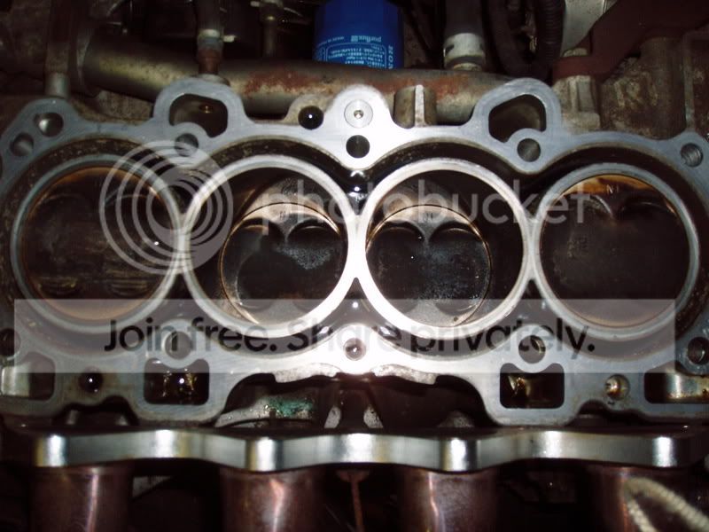

I am from the netherlands. I drive a civic from 1992 with a b18c4 engine. I have a oil problem. The oil consumption is very nasty. I use castrol 5w30 fullsynt. I use 1 liter oil per 500/600 miles. The higher te revs, the more consumption. I see lots of blue smoke coming out of the exhaust. The head was cleaned. New valve seals, new head gasket etc. My short block looked good. Compression was also good. Do you guys know what the problem could be? piston rings maybe?
Here some pics before and after the cleaning.

your piston rings are defiantly leaking. u can see a clean area around the perimeter of the piston (before u cleaned them). i would change the rings and hone the block, then put it back together and do a leak-down as you may have other problem areas also. i defiantly wouldn't go through the hassel of putting the engine back together just to leak-down test it because the clean area is a great indicator as to whats going on, although a leak-down would have told u alot about what was wrong before u tore it down.

it all depends on the condition of the bore (measured with a mic), if it has ovaled or gotten tappered then u need to rebore. if the cylinders are straight and round then reusing your pistons will be fine (as long as there is no scratches in the bore). an easy way to see if they are tappered is use a piston ring and start at the bottom of the bore, measure the ring end gap and write it down, then move the ring up in the bore and measure it again. do this in like 4-5 places and compair the numbers. if they are all the same then your fine to rehone and rering only. if they are different then u need to do the math and figure out the difference in diameter and see if its in spec. math is: pie times diameter = circumfrance.
