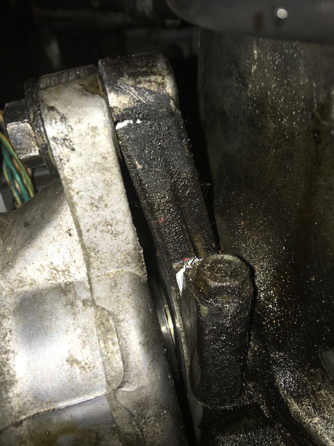

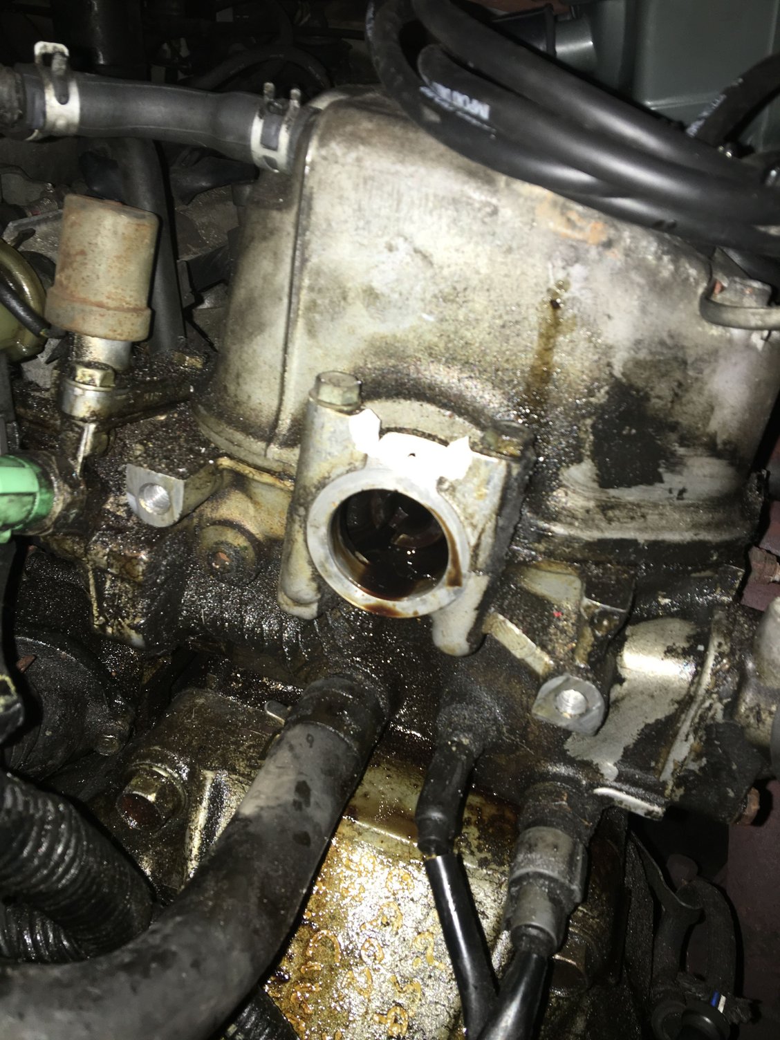

I've been looking awhile now for the name of this particular part and how the hell to replace it. Basically the part connected to the engine that the top bolt for the distributor goes into crumbled away when I was replacing my distributor. No one can tell me the name of this part or how to remove it, no one at any auto store has been help.
It bent as I was bolting in the distributor.
Completely crumbled away when I pulled the distributor back off.

d16z6, distributor cam cap.
Old Jan 3, 2016 | 06:32 AM
rudebwoy's Avatar
Posts: 2,738
From: Germany
Default Re: Need the name of this part and any info regarding its replacement
96 00 Honda Civic D16Y8 vtec Camshaft Cylinder Head Cam Caps D16 9103 | eBay
this should fit

Thank you guys so much! Went to 3-4 shops and no one could tell me what it was. Unluckily I live in an area massively over saturated with civic enthusiasts and every junkyard civic has people waiting for them the day they arrive and **** so that eBay link was supremely helpful. Thanks again

this will
For sure fit on a z6?

2 bolts will hold it just fine, replace the oring and call it a day.

Really? That doesn't sound right to me but I don't know **** about this

yes it will fit. but do you really wanna pay $50 + $16 shipped for that part?
