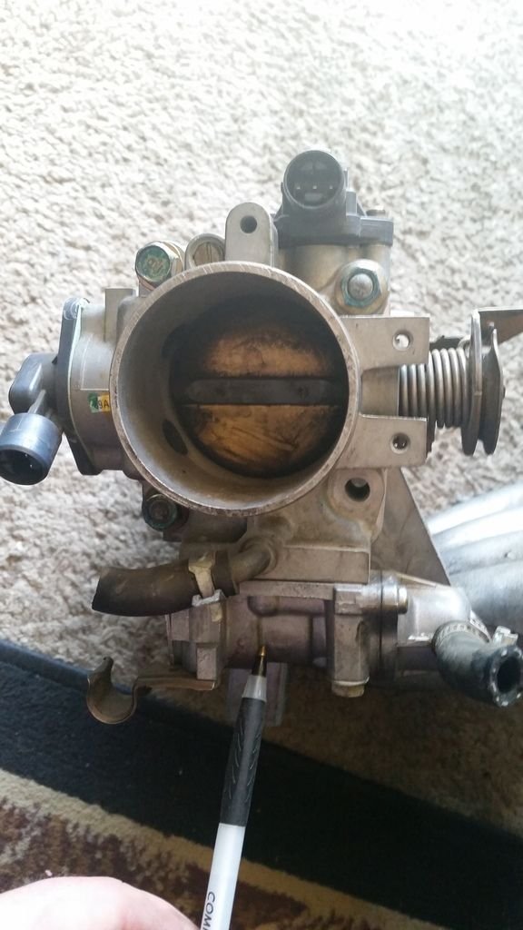

Thanks guys. I know it bolts up and I read to use the Gasket that matches the TB.
Here are some pics. I don't want to waste $$ on a gasket if this does not work out. Can anyone confirm this will work?
THIS one. Can I just block this off?
Here the b18 Auto TB is bolted to a y8 IM.

Yes you can block it off or running the cooling liines the same way.
