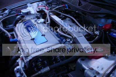

Here's a pic of the motor to give you any ideas if its breather lines causing any problems, i dont know?
Unfortunately thats the best pic i have for now.

i can say that up here in NewEngland the drastic atmospheric changes during the overnight can cause condinsation in the valve cover when you have big breather lines but it should go away after a few minute drive down the road.
if it is really thick and doesn't go away, your leaking somewhere. most likely the headgasket and in most cases you won't even see it on the dipstick till you've hurt the bearings.
try draining the oil and seeing what it looks like in a pan. most likely you will see some creamy stuff.
