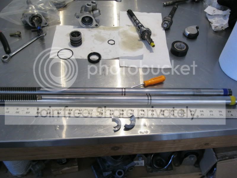

subframes are the same. If you want to de-power the rack permanently you can by cutting the seal that separates the inlet/outlet side of the rack. Its the circular pieces of metal laying by the ruler. It lives in the grooves you see in the racks you see in the pic above it.
I do not wish to "depower" my existing rack, I want to use a manual rack for the fact that the gearing is slightly different. Also thank you for your input
