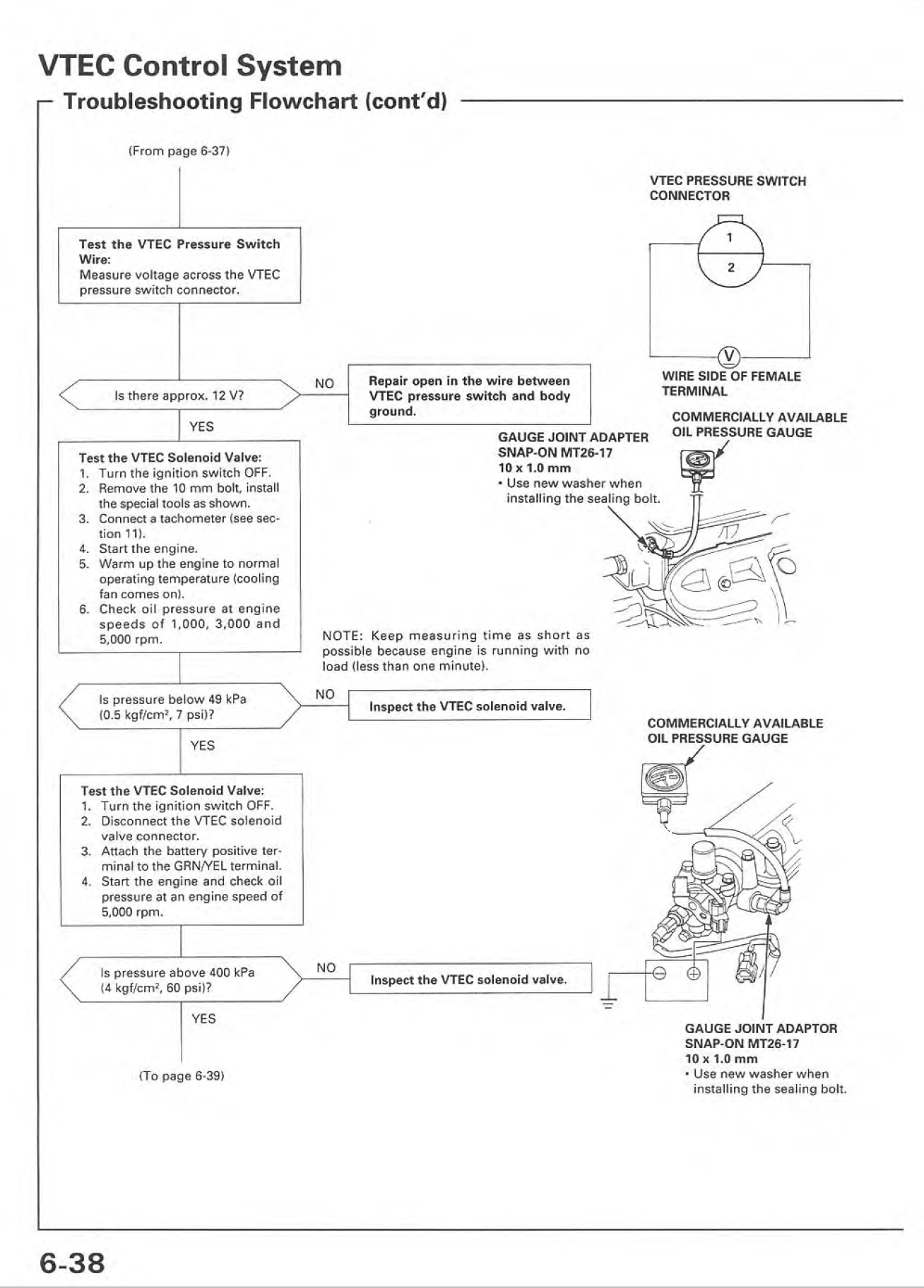

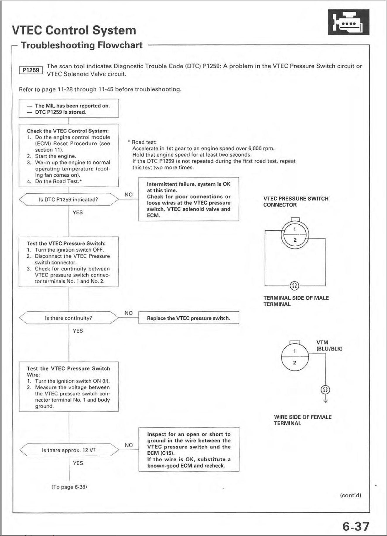

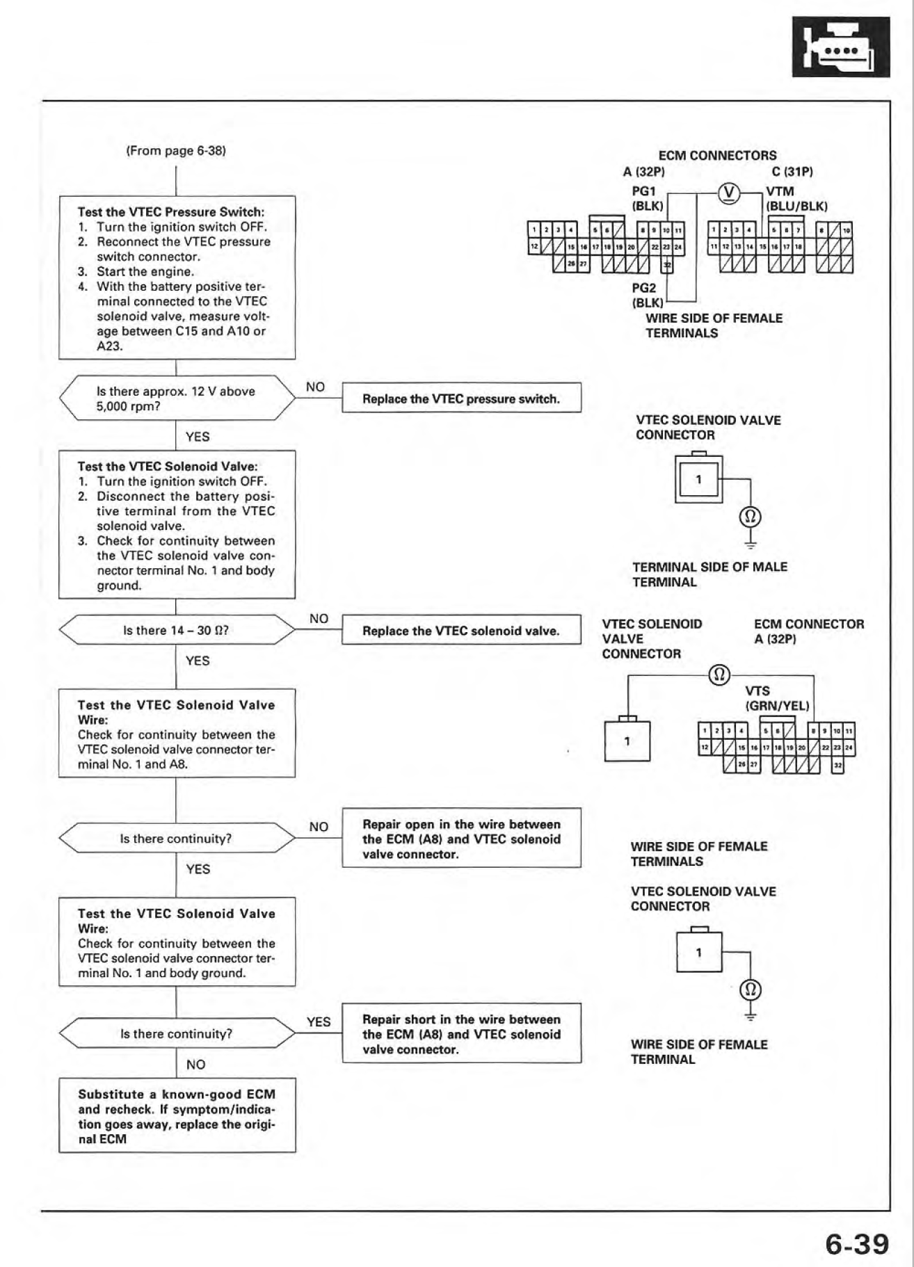

In regards to your vtec not kicking in, here's the troubleshooting flowchart for you:
Thanks for the vtec troubleshooting chart, I had already found a forum on it, but as a visual person the flowchart is very appealing. Thanks for your help and for reassuring me on the numbers!
