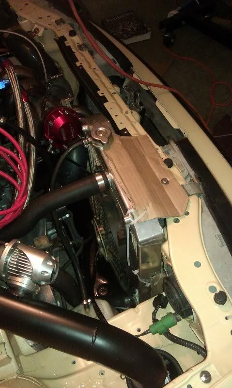

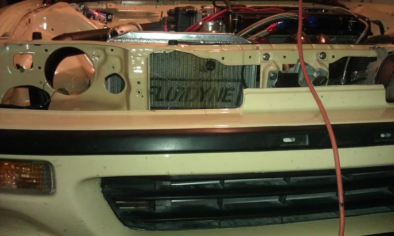

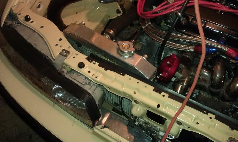

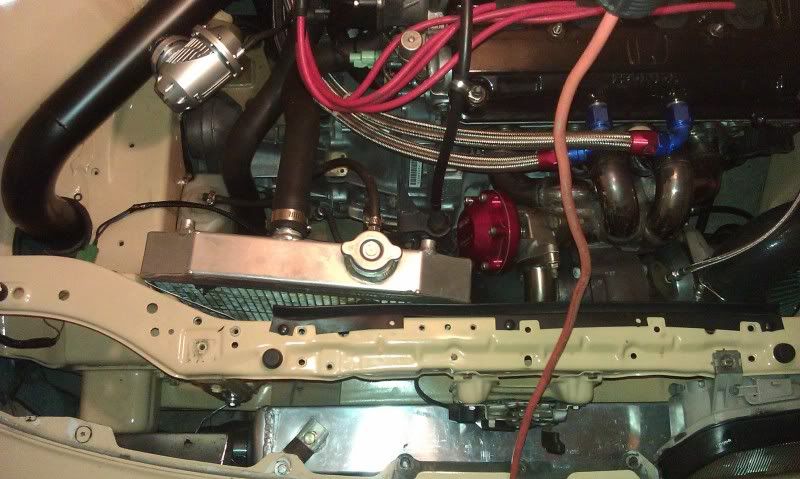

Radiator location, which is dictated by wastegate location:

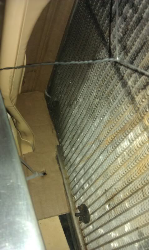

Ducting mock up:

This is the shroud I'm running right now. If I can ever afford a FAL that's what will replace it.
https://honda-tech.com/forums/showpo...70&postcount=8

Im thinking that you might want to get a full size radiator. But like you said, you are kind of short on space in there.

Problem is definatly airflow, [lack of], Jeezzz even the head light blocks part of the rad.
I would definatly look into a full size rad, even if you have to locate it in front of rad support and get rid of hood latch and use hood pins. 94
