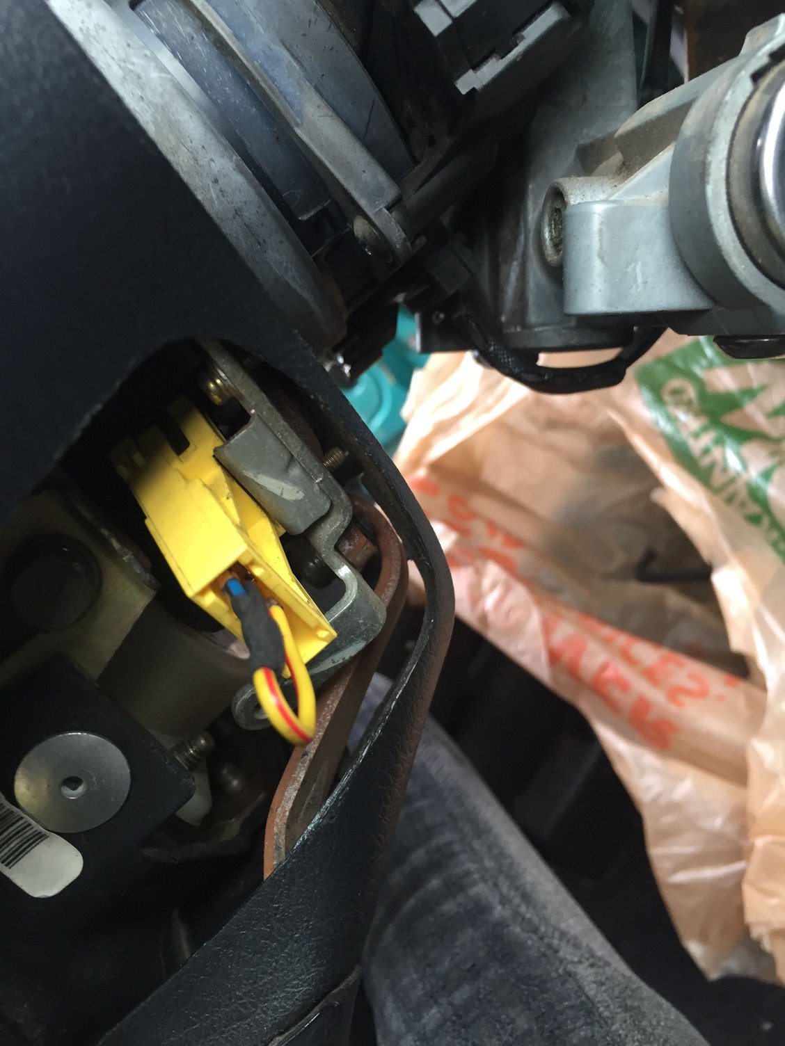

Found out why horn wasn't working.. Positive from the srs wasn't connected last owner had hacked wiring. got the srs cables. I only had cruise control so I jumped the connection from inside the steering wheel cruise control connector. Had to do a little adventuring with the ohm meter and figured it out
|-||| connected the lonely pin to the one that follows
