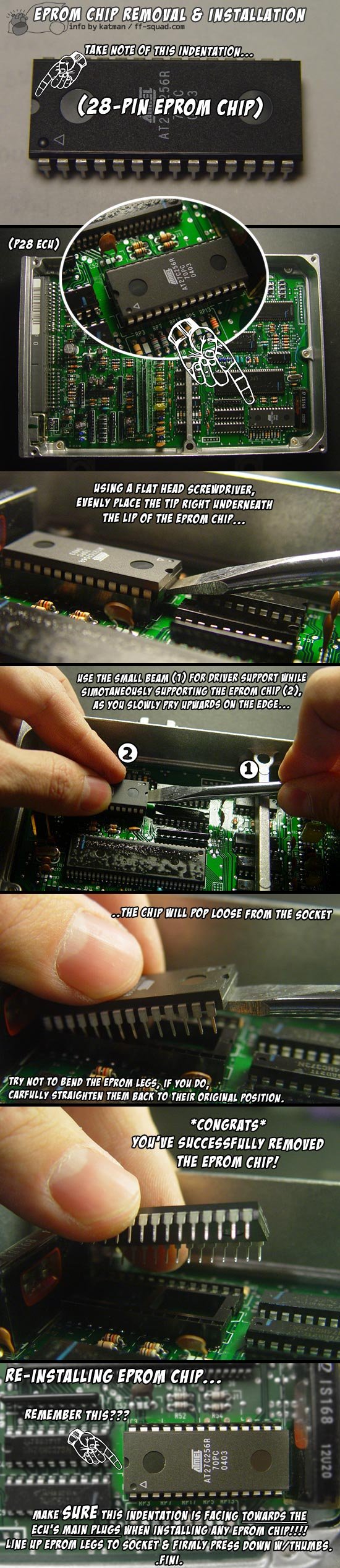

here's a pic to help:
http://www.ff-squad.com/tech/ecu/eprom.removal.jpg

K@man,
Man you made a Very Outstanding DIY. I give you hella prop's on that write up. Thanks alot!
