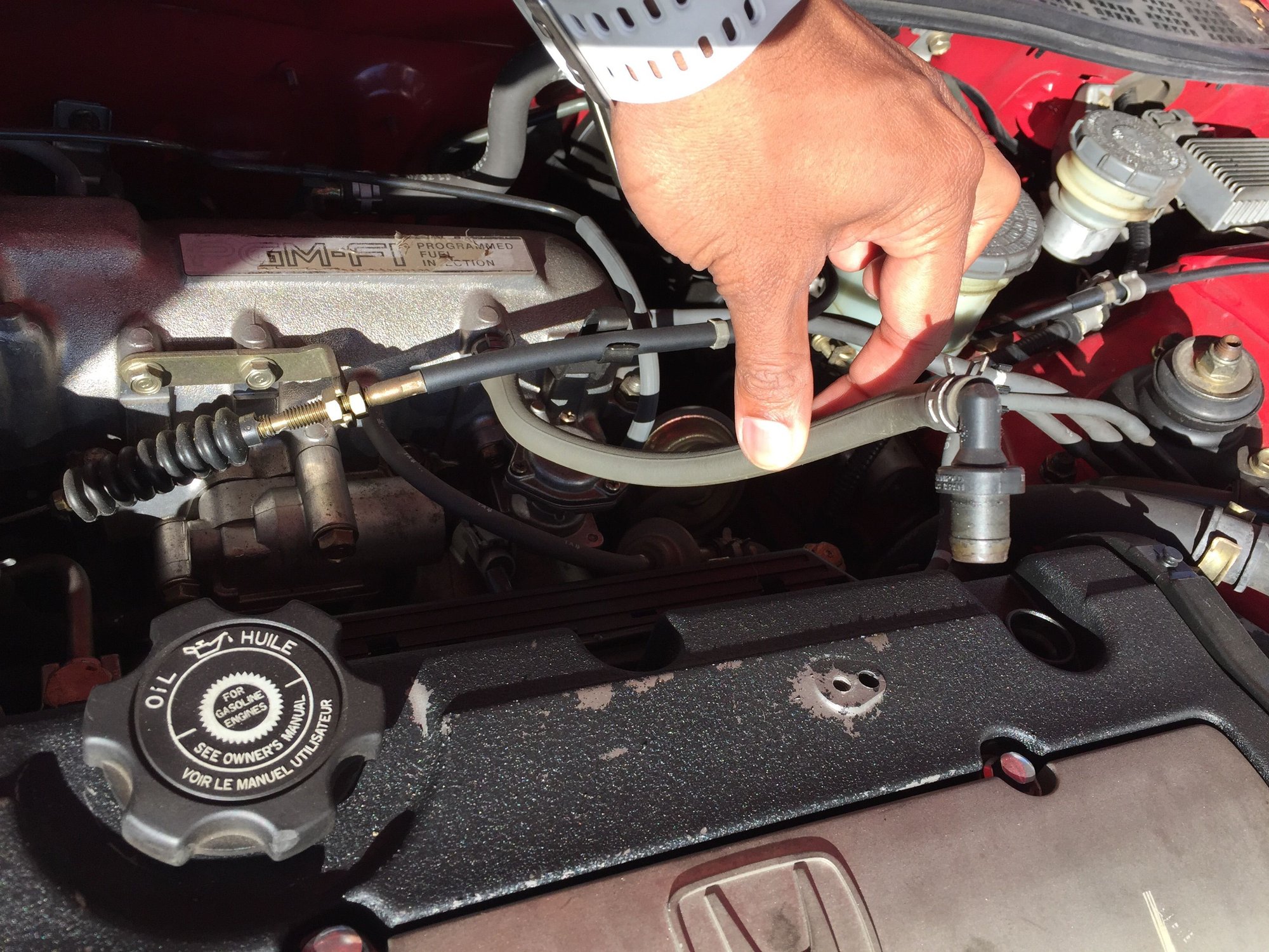

Doing 70 in 5th near LAX I pressed the accelerator and got a short delay, then a sputter then nothing. I immediately pulled over. 1st gear had little accelerations and feedback too so I rolled to the nearest gas station and am stuck here. I thought I needed gas, but popped the hood to find a small amount of smoke. Traced it and found one of my lines from the PGM-FI to the engine released from its home. Is it safe to simply plug it back in?
Of course I don't want it to fall back out. Please help. I thought to ask before I simply try to shove things back into the hole it was in. Pun intended happy Valentine's Day, everyone. Good thing I'm not on a date.

It is safe to plug it back in but I wouldn't expect it to fix the loss of power.

What's in your hand is the PCV valve and yes, plug it back into the hole. Without it, you have a massive vacuum leak and the car runs horrible.
Being it popped out is odd though, the valve might be stuck closed. The odd part is the pressure buildup would be in the crank case.
I can't say I'm familiar with the H series motor so am not sure the routing of the PCV system. But I do know, with it not in place the vacuum leak will cause serious operational problems.
Shake it and see if it still rattles, if not, you need a new valve as it's stuck open or closed. Either of which isn't good.

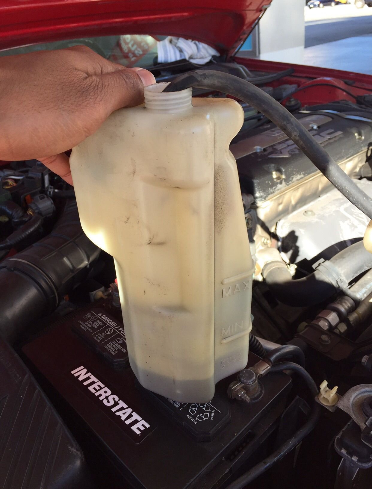

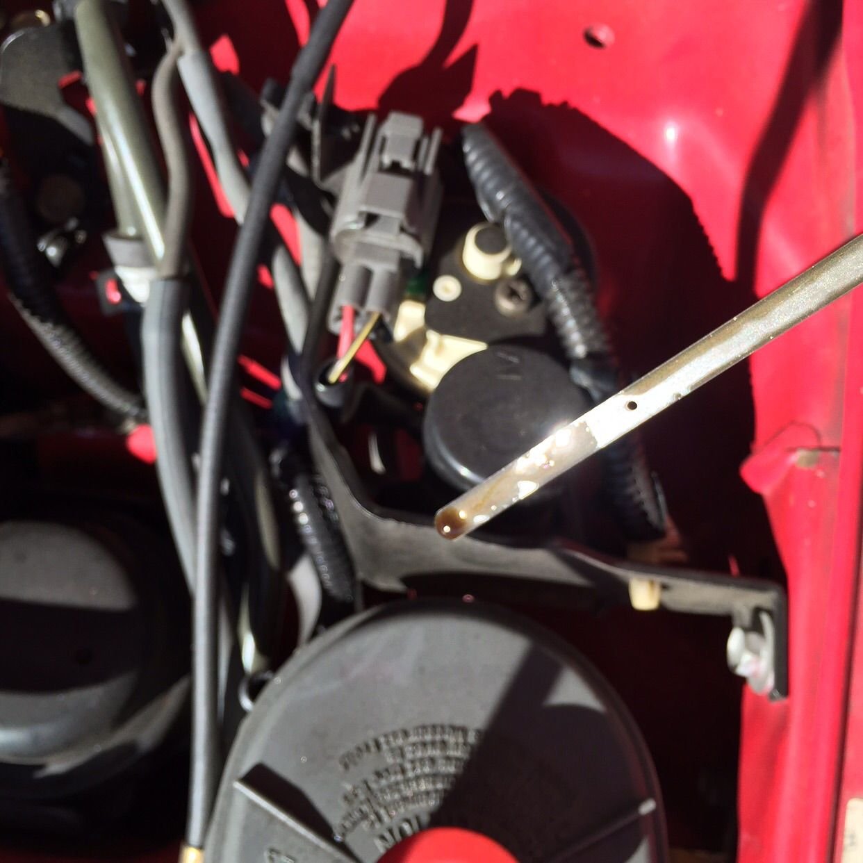

Just checked the tube PCV valve to see if it's stuck close. Shook it and yup. It rattles. Should I drive with it? If so how long, I can't imagine the part is expensive, but I don't know if auto one tends to stock a part like this.
Now that I know that, it's probably not related, but A friend said pressure built up and blew it loose. That makes sense since after plugging it back in, it's now snug and actually difficult to pull loose. Doesn't jiggle or anything either. She suggested I check the oil and coolant. And this is what I found. Gonna top or both and see what happens.

If it rattles it should be ok. Head to the nearest part store and pick up a pcv valve grommet. Its the thing that pcv valve plugs into. Your existing will likely be brittle and fall apart as you remove it so be careful not letting the pieces fall into the valve cover.
