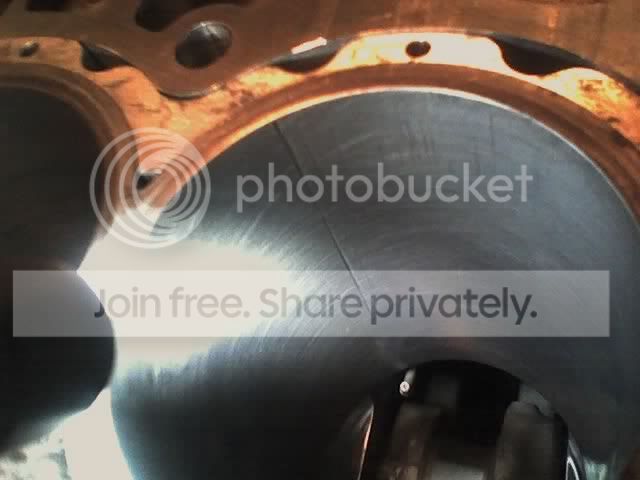

test results showed 190 190 210 210 from cylinders 1-4. on a cold motor.
I sold a car to a kid who thinks this is not good.
It is a usdm spec itr motor with jun stage 2 cams.
fuel pressure regulator went bad and during diagnosis a compression test was done giving those results.
swap had originally rc 310's in it.
he swapped to 240's and a stock fuel pressure regulator and car was ok.
3 months later he comes to me sayin that motor is shot and one of the sleeves is cracked.
Please give me some responses to show I am not to blame.
Is it possible to have a good a good compression test with a cracked sleeve.

He thinks usdm itr swaps are 11.0:1 compression. NOT. 10.6:1
He thinks the compression test results are off. NOT. they are all within 10% of each other.
CRACKED sleeved when I supposedly sold him the car back in November.
NOT possible.
we looked at all fluid levels then oil was pure oil. NO mixture of coolant or oil.
car would not run for this amount of time with the cracked sleeve.
The thing that gets me is he and his brother had the guts to take the head off to try to diagnose a problem (car was running rough and kept stalling out). I thought it was the distributor had them swap that out but no luck. This was back in December. Problem led to be a faulty fuel pressure regulator. Solution they did was stock injectors and stock fuel pressure regulator. They probably put it back together incorrectly and blame the problems on a car I sold to him. NOTE: they never opened a motor before. Did not know any torque specs or sequences.
Fuel pressure regulator problem: there's no way I could ever forsee that failing but it did. Things have a life span.
I just want people to respond that likely hood of me sellin him a car with a cracked sleeve is just not possible.

anyone with technical info now?
just need others with engine knowledge to state that the results from compression test that were done by him
190 190 210 210 from cylinders 1-4 are OK.
that a cracked sleeve would not give those results also.

If a sleeve was cracked you would not see those results as compression would definately find it's way through the crack. So you can tell him that there is not a cracked sleeve because if there was one of his cylinders would be reading WAY LOW like 40psi. The only way he could have a cracked sleeve situation with those numbers is if all 4 sleeves were cracked and the engine originally produced over 300 psi of ranking compression, which sad to say, is an unrealistic number, even if it was the starter would never turn the motor over.

Not going to happen. Those results are fine. Cracked sleeve is going to cause leak in chamber. *IF* you were lucky enough to crack the sleeve between another sleeve, it could leak into the adjacent cylinder and still in theory keep the compression results "up", but it going to show up with a significant variance... something more like 100-100-210-210. The guy doesn't know what he is talking about. Since the car was setup for 310's and he just swapped back in 240's, did he retune also?

no retune. running a chipped ecu.
the thing is he keeps doin search's and coming up that compression test results should be 260.
There's to many variables.
actual compression of motor.
cold or hot motor
actual gauge variances.
amount of carbon build up in head.
I told him as long as results are within 10 % shows good numbers and that there was nothing wrong with it then.

The guy doesn't know what he is talking about. Since the car was setup for 310's and he just swapped back in 240's, did he retune also?</TD></TR></TABLE>

Well, if the ECU is setup to feed fuel for 310's and then he swaps in240's and makes no changes, its going to run lean. I think we can all agree on that. This is problem #1. Problem #2 that I find with all this is that he is doing COLD compression tests. You are supposed to test the engine with it at normal operating temperature. Reading on the net that someone says you "should have" a certain level of compression means nothing. As you mentioned, carbon build up, open or closed throttle, battery voltage, elevation, temperature, gauge, etc will ALL effect compression results. Compression testing isn't supposed to be used to compare numbers with others from around the globe. Its used to get a general idea of how well the chamber is sealing. Doesn't sound like this guy knows what he is doing. He messed with some crap, screwed up, and now wants you to take the fall.

Look at your pic you posted we would have seen the scar on the sleeve back in November. You said we wouldn't be able to see that but we even cranked the motor to move the piston up and down you claimed one piston had play in it.
From my recolection we did crank it to move the piston to see if a rod was bent.
Remember that. There was no play in the piston. If you say that we didn't see that dam scar then your crazy.
Problem ended up to be the fuel pressure regulator. YOU said you fixed it and never contacted since. Car was ok after You claimed it to be.

You had the motor back apart back in December and you claim it was checked by your mechanic.
Now in June it has a cracked block.
Tell me how thats possible.
compression tests show that was not possible.
190 190 210 210 ARE GOOD NUMBERS!
how many times are you gonna argue and claim that the motor is NO GOOD!

that is one bad scratch. how does the piston look?

i am vouching that those compression numbers are good. Im an ASE certified tech for lexus however been into hondas for several years. maybe you didnt have the throttle open when you did the compression test? to be honest this thread should just end now because dave is clearly not a scammer, bad seller, nor a liar. and you have nothing to vent about anymore. case closed.
