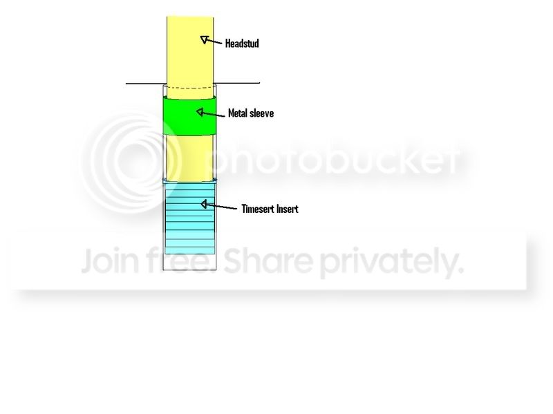

I ordered a Timsert kit for my B18C1 because it had a stripped headbolt thread.so i thought i'd repaired it but the insert came out (i think i messed up with the kit). i thought i didn't use enough loctite so i used some JB Weld so the insert would stay in there for sure. Well it didn't and to make it more complicated, i put in a metal sleeve in the hole and that is now JB Welded to the sides of the hole. (yes i'm a retard, but i need help getting this fixed)
so now i can't take out my headstud because the Timesert insert is still screwed onto the headstud and the metal sleeve is stuck and won't let me take it out.
Here's a diagram for clarification:
So what do you all suggest i do? one of my friends said to take it to a machine shop and they'd cut the headstud and drill out everything, then fill the hole with aluminum, retap it, and it'd be good as new.
what do you guys think? any guesses?

no the headstud and timesert are loose but i can't take them out because they hit that metal sleeve which is in there really tight.

thanks. yeah i took it to a machine shop and they cleared it out.
now the next problem is fixing the thread. there was a helicoil installed in it before, which messed up. and that's why i think the timesert didn't work.
i think i need to use some Timesert Big-serts, which are specifically for repairing the threads a second time or after use of a helicoil. only problem is i don't know any shops around my area that have those. i'll call around tomorrow. any ideas?
