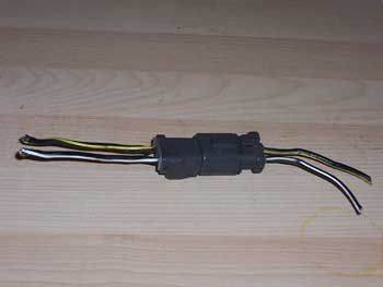

The wires referenced on this site http://www.civic-eg.com/causeforalar...onnector_4.jpg mention 10g Butt connectors for the wiring.
It's the same size that comes off of the ignition switch.
