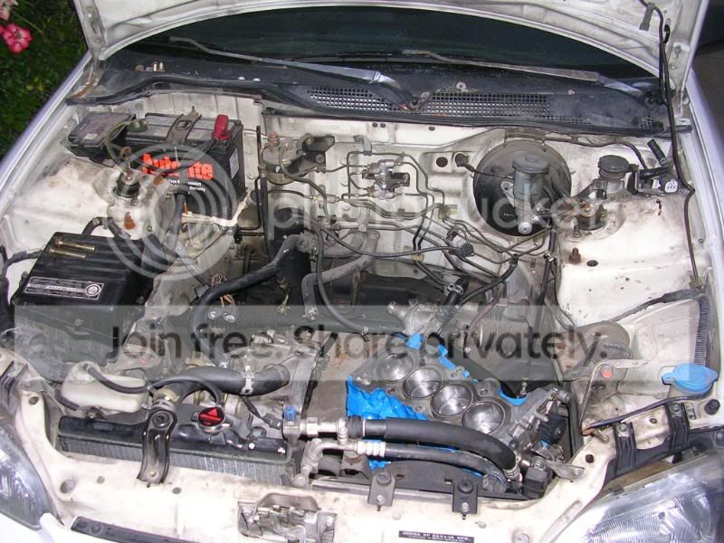

I recall reading you could drop and install an engine from below on the 92-95 civics. The key is jacking up the front of the car enough to slide the engine out and in etc.
Well, I just dropped the engine to the ground on my parts car, and I have a 48 inch 2 ton farm jack to lift the front of the car up and I think I can weasel the engine out around the 4 foot jack.
As it was I dropped the engine off my floor jack to the ground and hoping the oil pan didn't get dented from the 2.5-3.0 inch drop onto the concrete.
This exercise is making me wonder. What is the trick to install the engine without a crane?
Is there any tips or tricks I should know? I am working solo so that might also work against me.
Any feedback is welcome.
