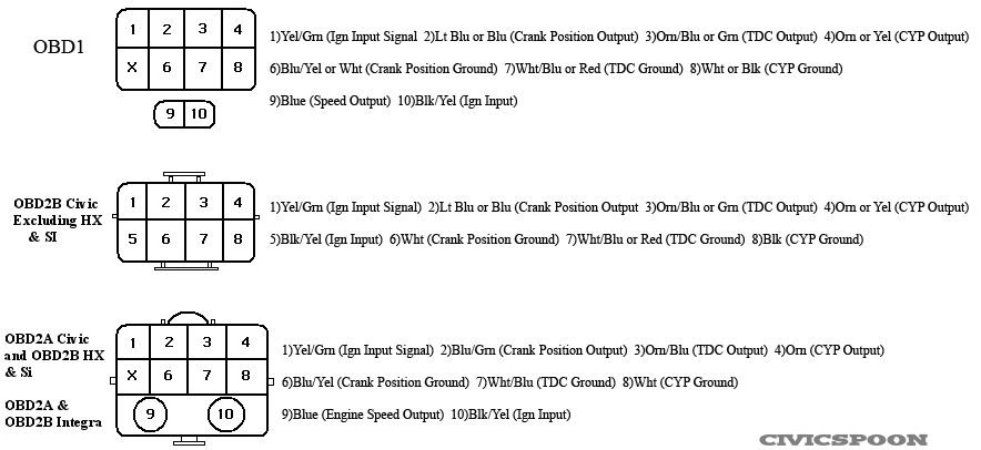

Alright, so I recently swapped a GSR into my EJ8. Now the problem im having is with trying to find the right distributor. Right now the car has a 99-00 SI engine harness on it, now the distrbutor plug on the harness should be a rectangular plug or the "small plug" right? If not then that answers my question, but continuing on with my question.. what distributor should I be looking for? Cause ive seen 99-00 Si distributors and it has the "Big Plug" and this confuses me lol. So if you guys have any input that can help me out i'd really appreciate it, thanks in advance.

if your using the 99-00 Si harness then it should mate with the 99-00 dizzy...make sure you have the Si harness

The '99-'00 Si uses the big 9-wire plug, not the smaller 8-wire plug.
