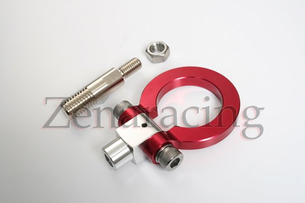

i have an integra and planning to install a splitter on the car. it will utilize my OEM tow hook so i will need an alternative tow hook point.
i was wondering if it would be possible to weld/bolt one of these to the front bumper reinforcement frame. http://www.harborfreight.com/automot...ver-67158.html
then attach one of these to the 2"x2" hitch.
http://www.harborfreight.com/automot...tch-66212.html
I figure this will be stronger than a tow strap.

bc this is the cheapest solution I can find that does not use an aluminum hook that is permanently bolted to the front bumper subframe and sticks out in front of the bumper. Also tow strap can go bad over time since it is made of a flexible heavy duty fabric material. Great for track, but I would like some stronger like a solid metal piece. Rennline makes a kit but it costs over 100 if u get receiver plate with screw on plus the toe hook itself.
I know 5000lb is over doing it but it is pretty cheap regardless.
Anyone care to give their input?

i thought about extending the stock tow hook but the car is already too low to begin with. I think a tow point from the front bumper beam is a better choice because some tow places would just tow you from the control arms anyways.
i believe the HF set up is about 12lbs?
i honestly don't know what i m going to do, might just get the tow strap and call it a day.....

that would be ideal. instead of cutting a hole through the bumper, i was planning on having the receiving end whether it's a threaded nut, or 2x2" square trailer hitch tube welded to a plate that will be bolted onto the bottom of the front bumper beam. that way, i can either insert a D-ring hitch, or one of the hooks in the picture above and have it stick out from the grill. no punch holes on the bumper needed.
do they make screw-type tow hooks in something stronger than aluminum? some tow companies would not tow from an aluminum hook due to liability reasons.
