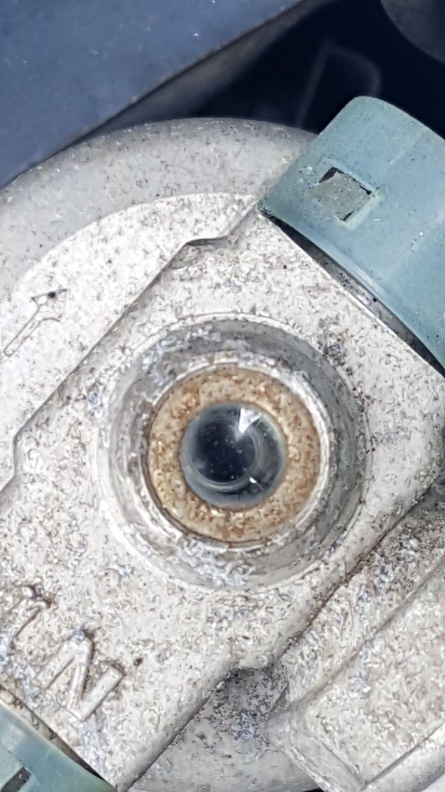

what do you see when you look down the sight glass on the alloy thing the pressure switch is on thats beside it?

Thank you so much! I thought it was one of those, should have unbolted and found out myself.
As for the sight glass, I see a bottomless black pit..see pic below. What does it all mean? Out of gas?

Looks like you leaked out your refrigerant. You can test for continuity at the ac pressure switch. No continuity means you're out and need to find the leak and fix it. then vacuum the system for about an hour after replacing the receiver/drier, check that it's holding vacuum, then recharge to spec.

yes looks like the case ...hardly worth getting fixed
@TakiTag does your engine fan (for the engine RAD ) work as it should?
yes looks like you are out of gas...
thinking back when we got the rocket the aircon rad was out of its mounts just sitting there and i remounted it correctly..maybe the pipe broke with it flapping round..oh well no aircon ..bugger
