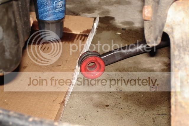

The "bolt" that comes off of the tranny housing is snapped.
http://s59.photobucket.com/alb...8.jpg
The one that this linkage attatches to.
http://s59.photobucket.com/alb...6.jpg
Ever happen to anyone? How can i fix this? Just weld on something comparable?

from the pics. it doesnt look like just the bolt. it looks like the housing the bolt goes in snapped off. correct me if i am wrong.

there's a flat washer that goes on and then the piece (pictured), and then the washer for the bolt. It looks like the cylinderical piece that the pictured piece slides on is what has snapped off. Without that piece, nothing will be able to hold that brace on. I would assume that you would need that brace. dont know how else you would be able to attach it. Hopefully, maybe someone knows, otherwise its either used tranny, fabricate or go without it.

drill and helicoil that bolt hole, then have some one weld a round stock the size that uit was

just take a chisel and tap it out with a light hammer....ive come across a few trannies that have had this happen...the bolt usually gets going fairly easy

yes the bolt goes through the linkage into the transmission....just be sure to use a large enough washer or else the linkage will fall right off after a few shifts...trust me ive made that mistake before

I wouldn't drill, I'm in the process of replacing a case, they used a bolt that was 5mm too long where yours broke.
The bolt punched thru the thin casing, causing a massive leak.

Turk, you're a boner. He DEFINITELY broke off part of the housing, not just the bolt, so we will have to "engineer" something. I have a really simple idea for it that will have to be executed when we get the motor/trans out of the car. It involves a spacer to fit inside the linkage rod bushing, a Superman cape, a die grinder, a big clamp, blue body paint, a tap, and.......I've said too much.
