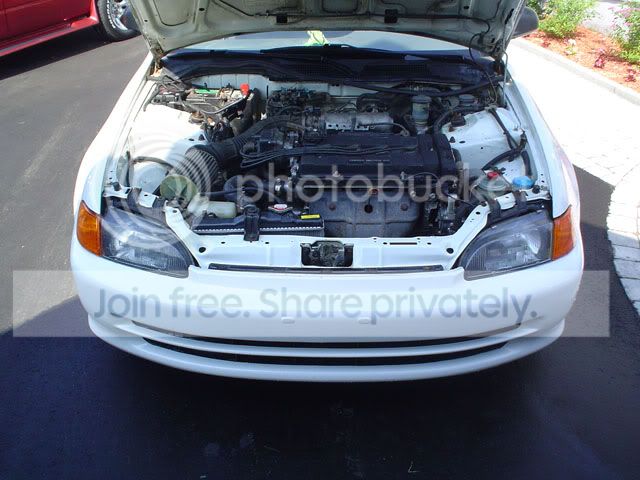

I swapped a B18B1 with a P75 ecu into my 92 civic lx
Everything is fine, the car can run, except that the motor runs extremely rich...
we found out that I have two map sensors... and the two connectors seems to be working......
could it be what makes the engine running rich ??? or could it be vacuums plugged at wrong locations ???
