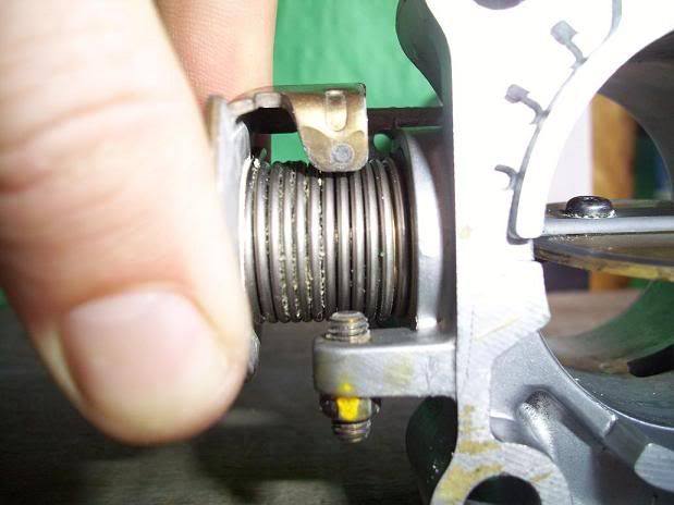

Do the usual carbon cleaning? Clean TB, idle control motor/screen, and adjustment screw. The screw is on top of the TB. If it is actually untouched then it will have a grey sealant over it.

Make sure your throttle stop screw is still in place. If it is adjust it up till it idles at 700-800 with the iacv unplugged and your car will idle great again.

Thanks I’ll check for it and give this a try. What if I don’t have it? And the idle adjustment screw is the flat head screw at the very top of the TB?
