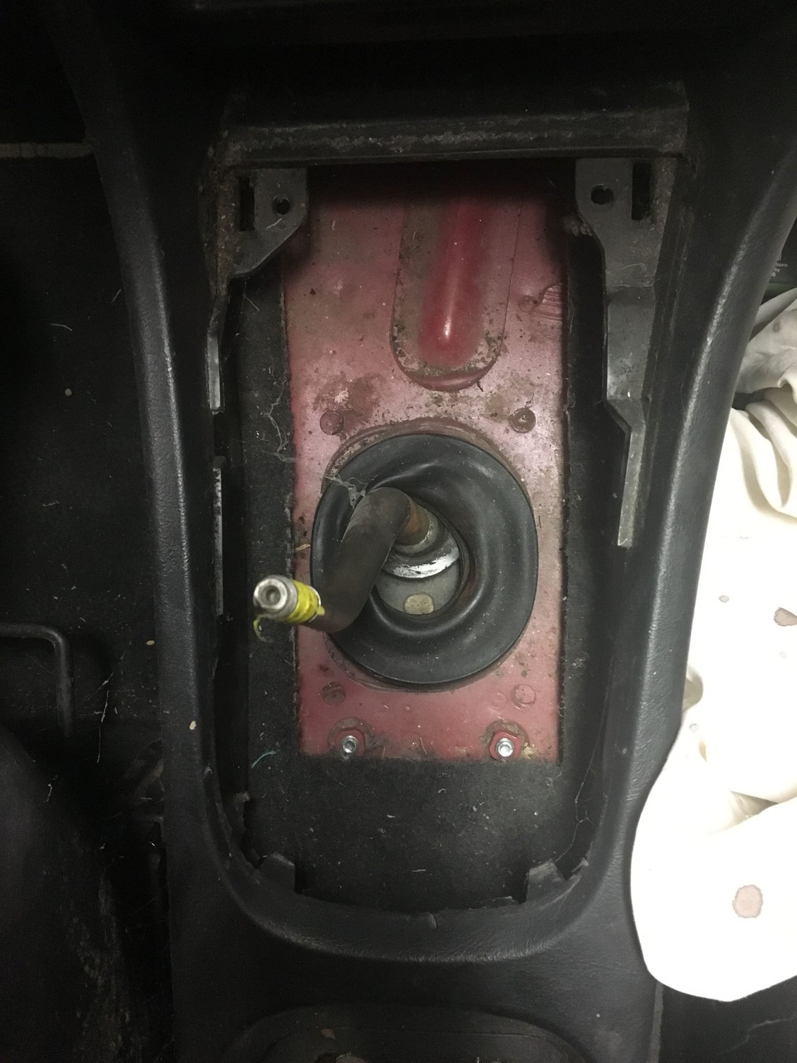

Assistance Needed: Shifter Linkage misalignment
Old Nov 15, 2016 | 04:32 PM
lolv8s's Avatar
10 Year Member
Joined: Jan 2013
Posts: 505
From: Texas
Default Assistance Needed: Shifter Linkage misalignment
It's in neutral.
ok I really hope I didn't get sold the wrong shift linkage. B18A1 GSR transmission 1996 DC4 Integra coupe. Any small things too look for? Or anything I should know about? Previous owner put in a short shifter.
Old Nov 16, 2016 | 04:36 PM
fcm's Avatar
fcm
Old Fart
Posts: 26,173
Likes: 18
From: kelowna, bc, canada
Default Re: Assistance Needed: Shifter Linkage misalignment
Sounds like you have the wrong extension change rod, #14... SHIFT LEVER for 1996 Acura INTEGRA HATCHBACK or it is bent. 94

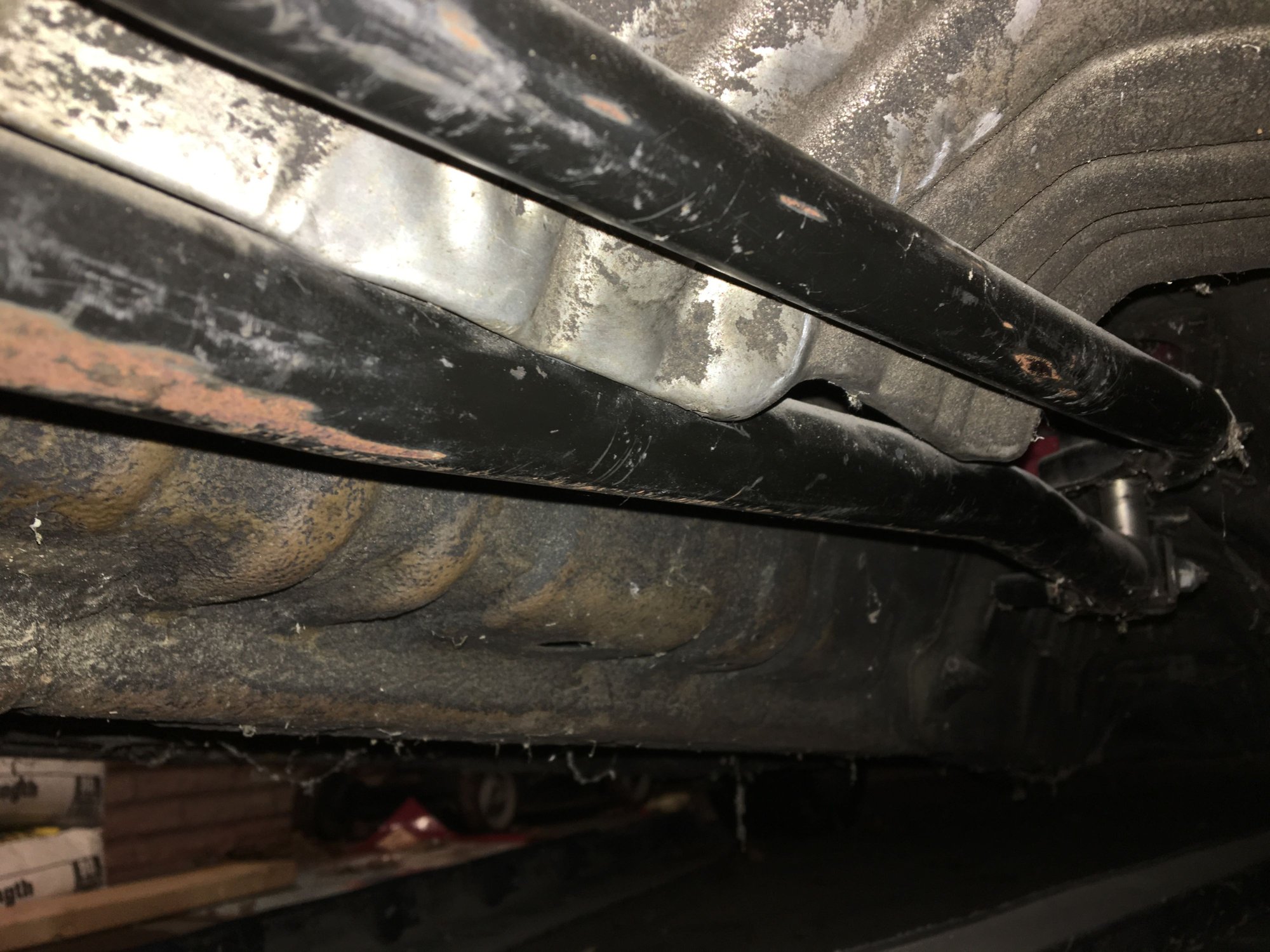

Old Nov 22, 2016 | 04:24 AM
lolv8s's Avatar
10 Year Member
Joined: Jan 2013
Posts: 505
From: Texas
Originally Posted by fcm
Part number maybe, don't know if and where it would be.
I guess there is also a possibility the change rod, #13 is the wrong part and it is too long. 94
took some pics. Think the exhaust shield is bent. But things don't exactly look right. Exhaust shield and the linkage are touching
Old Nov 22, 2016 | 11:13 AM
fcm's Avatar
fcm
Old Fart
Posts: 26,173
Likes: 18
Is the change rod installed upside down, or is that even possible???? 94
