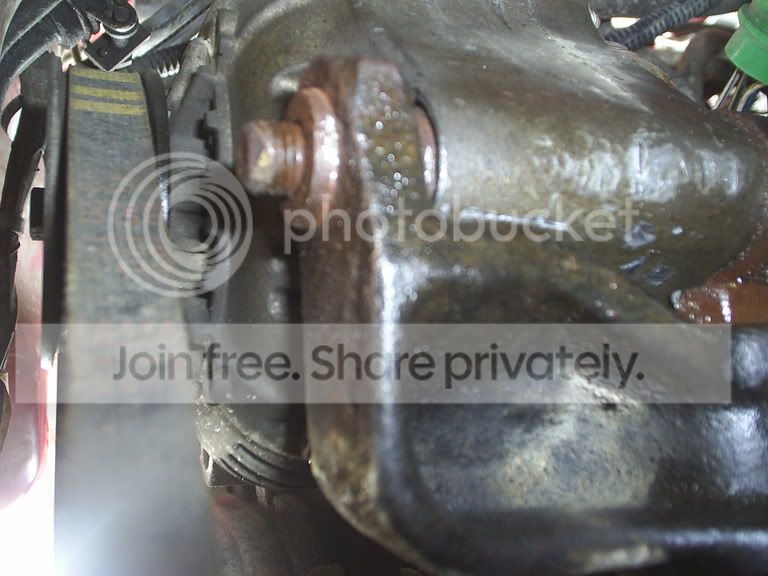

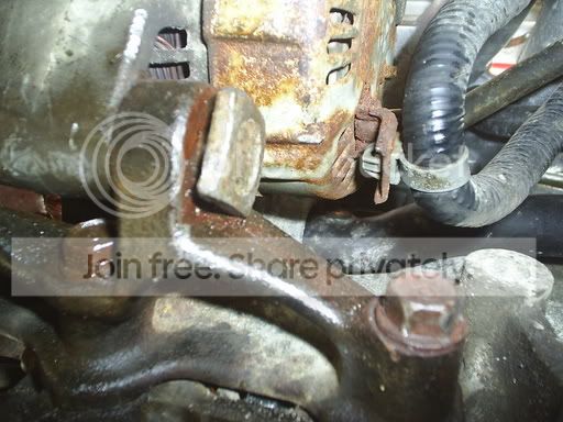

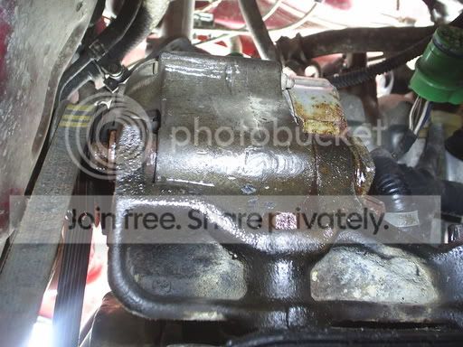

Ok, looking for some help. My friend's got a 93 Civic DX with a bad alternator. I figured NP, alternators are easy. Get over there, get the electrical connection off, get the top bolt off. The bottom bolt, however, is like a 1 inch square bolt. The other side is just threads?? WTF? Doesn't budge, can't hammer it out, and the alternator bracket bolts underneath are stripped? Anyone got any pics of what to do, any help would be much appreciated! Thanksd in advance

Ok here's some pics!

Could you use a punch and punch the bolt out? From left to right on that last pic?

Remove the 12mm nut on the adjuster bracket (On top). Then remove the 14mm nut on the lower bracket and remove the belt.
To get the lower bolt out, I would take a pry bar to the square end of the bolt and pry it out as far as possible. Then I would just pivot the alternator back a forth while pulling on the pin. You could also try hitting the bottom of the alternator with a hammer to try an loosen that bolt up.

I used a big chisel and a BFH, didn't budge at all. Used alot of WD-40 to
