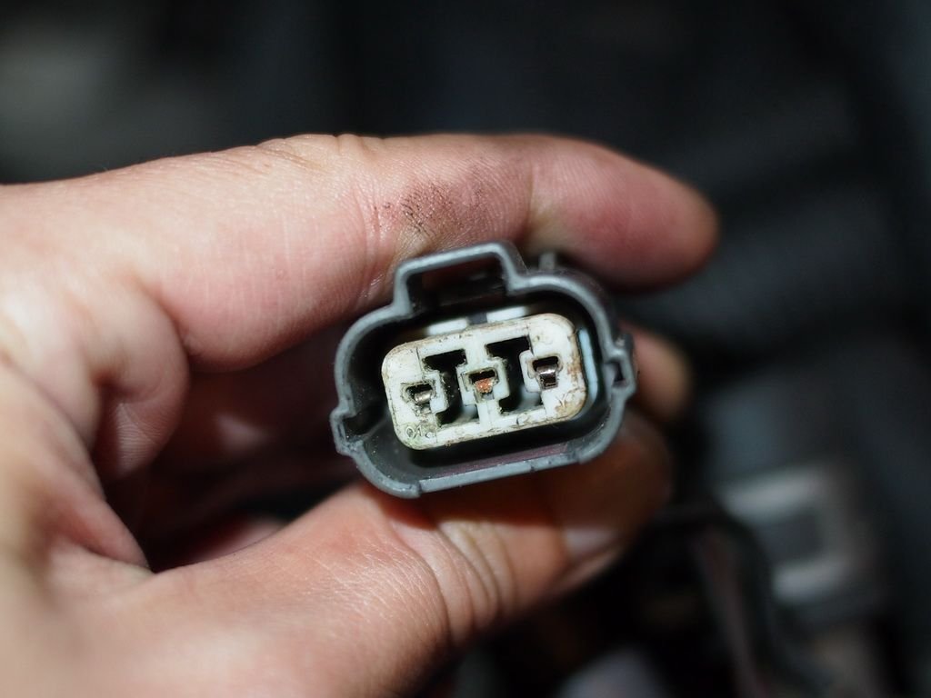

I tested the harness side of the VSS plug by using my test leads on the thermostat housing... the black ground wire on the plug DOES have continuity, the yellow/white wire with the key on is putting out 4.8v and the yellow/blue wire is putting out 0.7v I think that's low... but I don't know what to do from here.... any ideas?
Old Apr 18, 2016 | 06:36 PM
phrenzy's Avatar
Joined: Feb 2008
Posts: 140
From: reno, NV, USA
Default Re: 96 civic speedo problem
I can't figure out the problem... it's probably the plug but I did find 2 wires... one is a huge connector that isn't connected to anything and the other looks like a 2 pin connector that was intentionally taped off... don't know if that can cause any problems but this is the first I've seen it...

Swapped the VSS just for ***** and giggles to one that I had laying around and it didn't change anything... it's probably the plug or harness somewhere near where I was working on the alternator. both the ECU and the speedo aren't reading the VSS so it must be somewhere close to the plug... Hope I can find the problem soon.
Old Apr 19, 2016 | 11:11 AM
phrenzy's Avatar
Joined: Feb 2008
Posts: 140
From: reno, NV, USA
I guess that picture on the bottom is normal that its not connected to something... just from looking at a wiring harness in a picture.
