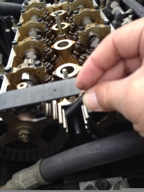

With the valve cover off I crank the motor and the cams dont move. This is causing the rotor to also not move.
My next step is to inspect the crank area that connects to the TB since the crank turns but the TB and cam gears do not. Do you know what kind of material the gear is made of that turns the TB from the crank?

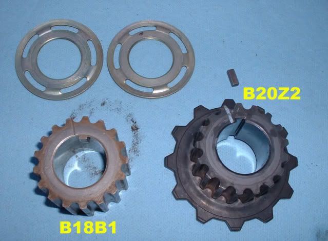

There's a woodruff key that hold the timing belt gear it most likely is that. To check it you have to pull the accessory crank pully off and all the belts. Good luck its not that much work. Hopefully your valves aren't bent.

either way youll need to pull off the crank pulley and timing cover
because its lasted so long without problems, im thinking its missing that little restricter plate on the crank, that keeps the tb from walking off. his belts are spinning so i think the w key is there
the timing belt gear doesnt have a woodruff key, its built into the gear. if i remember correctly

If that plate was missing he wouldn't have tension on the belt. He said he did have some tension not exactly sure since he didn't state where he saw the deflection. Either way all that has to come off to check.
And check your valves
Edit it is a woodruff keey this is what ur lookiing for.

im was talking about those 2 platesat the top

Yeah I guess there all a little diffrent. Mine was for a gsr crank. Till the covers are off we'll see, but I bet that peice in the left side broke off.

yeah i think my 96 b18b has the w key built in the crank but a pre '96 ls crank unknown year i have has the slot in it for the w key, now that i think of it

I didnt get to taking off all that I needed to because I car isnt in the garage and is in the street but heres where im at now...

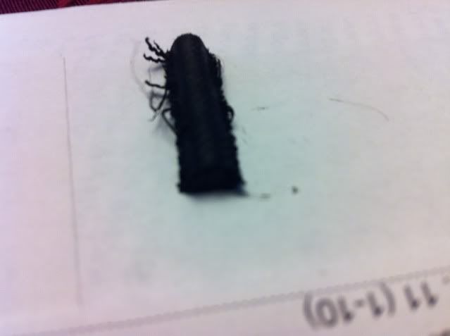

I removed the mid plastic cover just under the VC and found out the the gear itself on the crankshaft does indeed turn. I also found shavings in the cover as well as a rubber TOOTH from the TB.
Im gonna have it towed to the shop and have them replace the TB and or find anything else wrong with it.

UPDATE - Timing belt replaced. Started right up. Compression and leakdown test were good!
