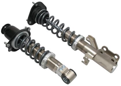

Now, not to add confusion to the game...but in the $550 range you can find Progress CS-II coilovers and you can pick your spring rates (meaning ride quality), and choose whatever drop looks good to you since the height is fully adjustable. Don't forget you'll need alignment every time you change the cars height...so if you take this route choose one height and leave it be, but you'll always have the option to lower or raise it in the future... the great part about this setup is the fact that you can purchase the springs w/stiffer rates for cheap just in case you decide to do an event in the future.
EKForever, and a couple other guys here use this setup, they're tried and true...and pretty much OWN any other coilover in the same price range.

Now, not to add confusion to the game...but in the $550 range you can find Progress CS-II coiloversand you can pick your spring rates (meaning ride quality), and choose whatever drop looks good to you since the height is fully adjustable. Don't forget you'll need alignment every time you change the cars height...so if you take this route choose one height and leave it be, but you'll always have the option to lower or raise it in the future... the great part about this setup is the fact that you can purchase the springs w/stiffer rates for cheap just in case you decide to do an event in the future.
Are these coilovers any good? I was thinking about getting it for my em1.
