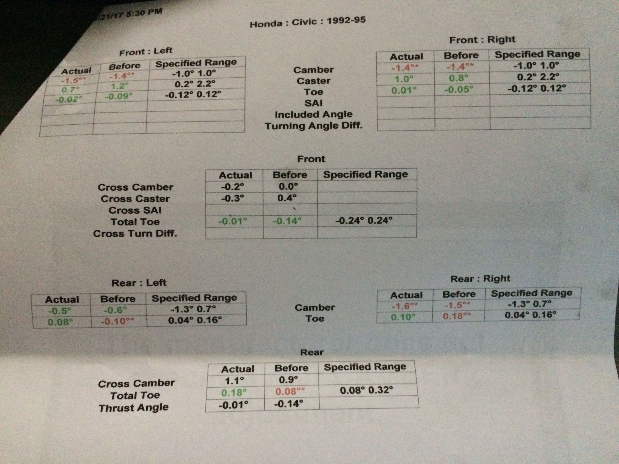

Hi all,
The other day I went for a drive in the mountains. I noticed the car felt somewhat vague turning right. I got it in my head that perhaps I should play with the rack guide adjuster to "tighten" up the steering. This only made the effect worse, so I took the car in for an alignment. They said my caster was messed up and shifted the subframe. No change to the way the car drives. I found the steering too tight to my liking so backed the adjuster off until it felt "normal".
Basically the problem I'm having are: 1) steering wheel is off-center (car goes left if steering wheel centered). 2) With no hands on the wheel the car pulls to the right in every gear at every speed. This is very evident when turning right at a slow speed from a light, almost feels like the car wants to hit the curb. 3) Turning right is basically vague and imprecise and the steering wheel doesn't want to self-center all the way after a right turn. Does anyone have any idea what the problem could be, or give me some ideas of what to check?
The car is a 93' Civic DX manual hatchback with ~210,000 miles. Steering rack was rebuilt not long ago, and all ball-joints and bushings are new. The car has Koni/GC coilovers, 21mm front swaybar, 22mm rear swaybar (with ASR brace) and 15"x7" Enkei RPF1 wheels. I've attached the last alignment I got.
Thanks!

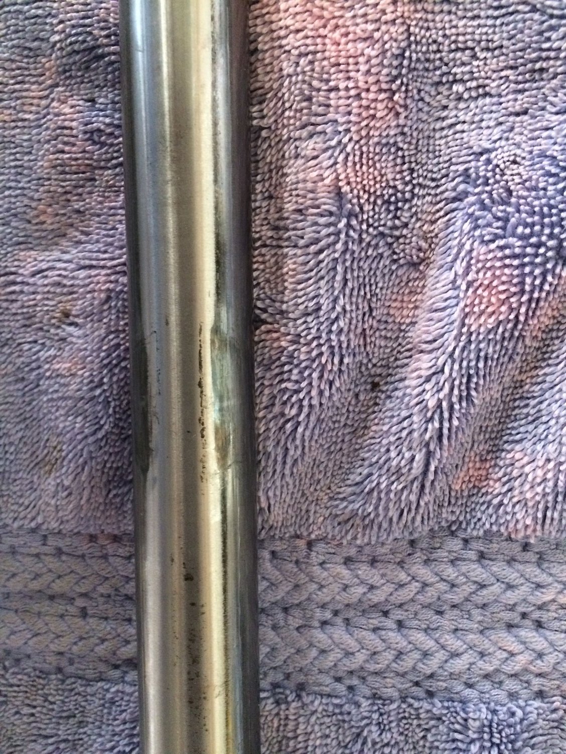

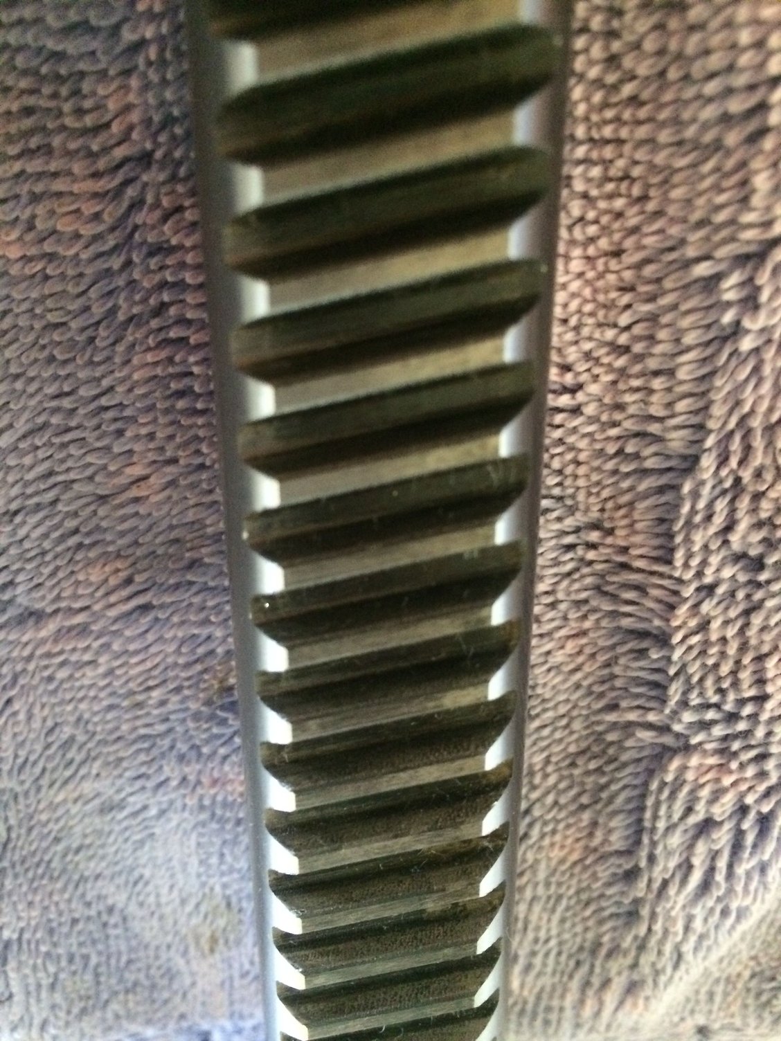

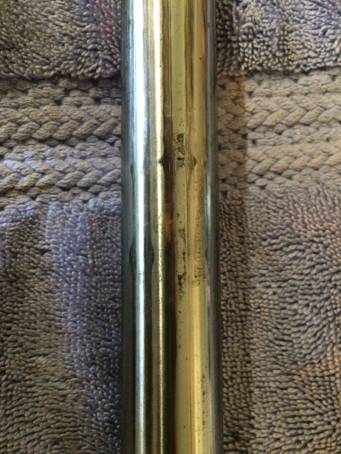

I took the steering rack apart on Friday, unfortunately I can't find anything wrong with it, so I'll be putting it back together. Whatever is causing this problem is still eluding me. The only wear I could really find on the steering rack was on the back of the rack gear where it contacts the rack-end bushing and the rack guide, but I think it's okay, although I don't know what I'm looking for totally. There's clearly some wear on all the surfaces, but I'm not sure it's abnormal, it doesn't look like it to me. Once I get an alignment I'll post back if the issue persists.

Find two straight edges and roll it across to see if it's bent.
What are you trying to show around those burnished areas?

Good idea with the straight edge, I'll give that a try tomorrow. I'm assuming if it was bent - it wouldn't be dramatically so? I was just trying to show how the burnished areas have worn, I have no idea what's considered normal or acceptable in this regard. On the passenger side of the rack, you can feel the burnished areas with your thumb - it has worn enough. I was hoping this would be destroyed on the inside, but if it is damaged, it's not obvious to me.

Good news. Got an alignment yesterday and the car feels much better.
Here's the interesting part, when I got the car back the alignment tech said that it still pulled a little to the right, it wasn't bad though. Since it got very cold today I decided to switch to my all seasons. The pull to the right is gone now. The car still seems to "favor" going to the right a bit, but it tracks pretty straight with my hands off the wheel. I'm very happy with it now though, the steering has a nice weighting to it and centers nicely. Thanks for the help everyone!
Now I'm wondering if something is wrong with my summer tires? I'll rotate them once I put them back on, but it may be some time. My theory is that the previous alignment was not good and created a wear pattern causing the pull. Getting a better alignment reduced this. Not sure though.
