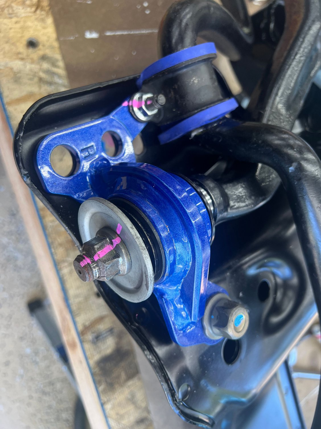

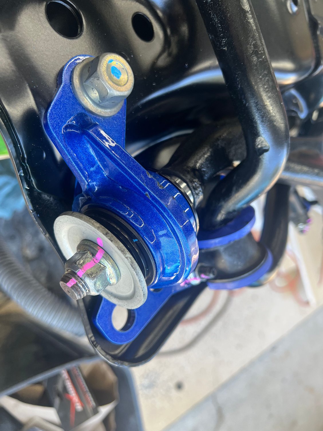

What did you end up doing? I ended up grabbing the PCI setup (compliance bushing and arm) for my EG. I'll put em in sometime in June most likely.
I initially wanted the Hardrace arms (same as the Truhart but blue) but Hardrace discontinued them. I asked why, and they told me customers had issues with them.
In my searches, I've encountered multiple people citing issues with the hardware on the whiteline kit. Hardrace does sell a similar kit, though, FWIW.

BTW, I had a bunch of noise develop in the first month/1k miles with the PCI arms and had to pull them.
Considering upper arms and the Hardrace caster kit (hopefully better hardware than the Whiteline one) to get the caster back because it did make a positive impact.

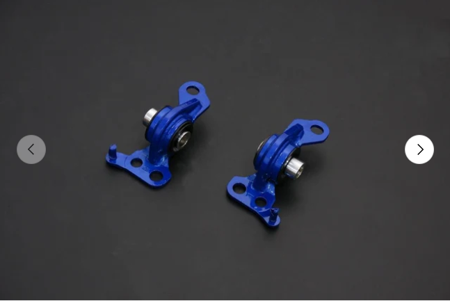

Probably will just end up trying the Hardrace shim kit since apparently the hardware on the Whiteline kit is not trustworthy and breaks.
