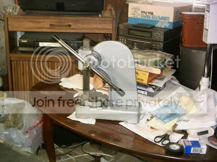

I came along this great buy in the JCWhitney catelog, and wanted all the Integra owners who have been wanting to do their bushings to take a look.

not a bad buy. so.......obviously bushings is what you bought it for....does it work good???

Yep

I was under the impression that 1 ton was not enough.

if hand pressure is enough i'm pretty sure 1-ton is.

Wish I would've seen this before I spent 5 bucks per bushing to have them pressed out (installed energy suspension master kit).
There's 2 per front LCA, 2 per front UCA, and 1 compensator arm bushing each side.
I paid 50 bucks just for the front.

I just did some of my rear control arm bushings. This press won't remove the original bushings, but it will press in the new ones. I had to torch the originals with a $15 propane torch from Ace hardware, and then I took a hacksaw to cut the outer shell, then an old screwdriver with a hammer to knock the old outer shell out. The press did make easy work out of putting the new bushings back in.

i just lit all mine on fire and scraped them out. Then i pushed all of them in with a vise. Worked just fine.
