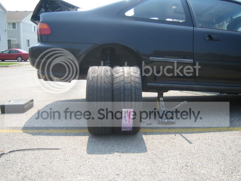

just cut the rear fenders and prep them. Rolling them will do more damage than good. Just don't let peeps lean on your rear fenders. slight roll on the fronts. you already know that you need some sustantial camber for R-comps so do it up.
I run 225/45/15 RA1s on rota slips 15x7.5 40 offset. Clears RTA perfectly (main concern for most). Cheap, clean, light setup.

HAHA 205/45/16 Hankook RS2 vs 225/45/15 toyo RA1
This day I realized I needed some fender work
