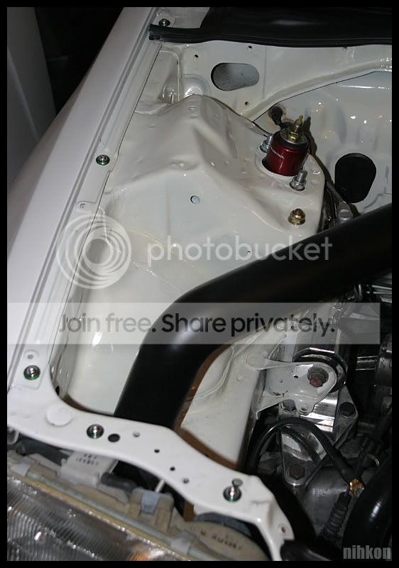

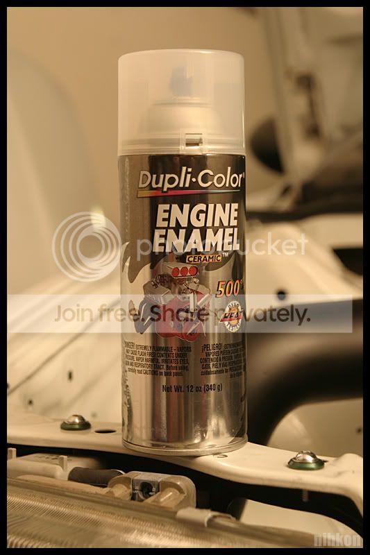

I'm touching up my engine bay a little bit. I sprayed (with a can) some white touch up paint. Then I went over it with some high temp. clear. It looked great for a few days, then it began to yellow a bit.
Is this due to the type of clear I used? Or maybe I laid the coats on a little too thick? Or what?
Are there any spray can clears that are better quality that won't yellow?
Here's the paint I used:
And here's the section of my engine bay that I painted:
You can see that the engine bay no longer matches the outside of the fender. It did match pretty well before it yellowed.

Most cheap clears have a yellow tint to it. The more expensive brands like House of Kolors is crystal clear, but its not cheap like i stated.

I think its just that clear that yellows. The reg. clear that they sell will work
I have noticed the engine enamel clear turns yellow when its dry, I tried it on my headlights once

There you go A descent 2K clear would work way better.

you can go to a local shop that makes auto paint and they can put anything in a can. If you buy HOK clear you can take it them and they can put it in a can for a small fee. Also I'm still trying to figure out why you are using high temp paint on an engine bay? that is for engine blocks and heads not engine bays..

BTW the heat that your motor puts off cures that paint so just use some krylon clear and see what happens.

It may be turning yellow because its heavy in those areas..Some clears have a yellowish tint(its a UV protectant)in them to help with weather.But u cant see it when sprayed

Ep1dem1c: Oh yeah, I've heard about getting spray cans filled. I forgot all about that. Maybe I'll look into that to see how much it costs. I used the engine paint with the thought that it would hold up to the heat of the engine bay a little better than regular clear. [shrugs]
Bigblockhatch: Yeah that may be. I did spray a bunch of coats, so it's probably pretty thick. And it is most yellow in the area in front of the wiper motor hole where I got a little trigger happy and it pooled up slightly.
