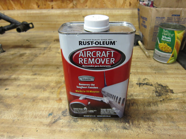

I don't know what it will do to the hoses, and I don't know how you plan to apply and clean off this stuff. But, it absolutely destroys paint... And gloves, and your hands, just everything. Be very careful with it, read the label. Should be very easy to obtain; Walmart, Autozone, etc...

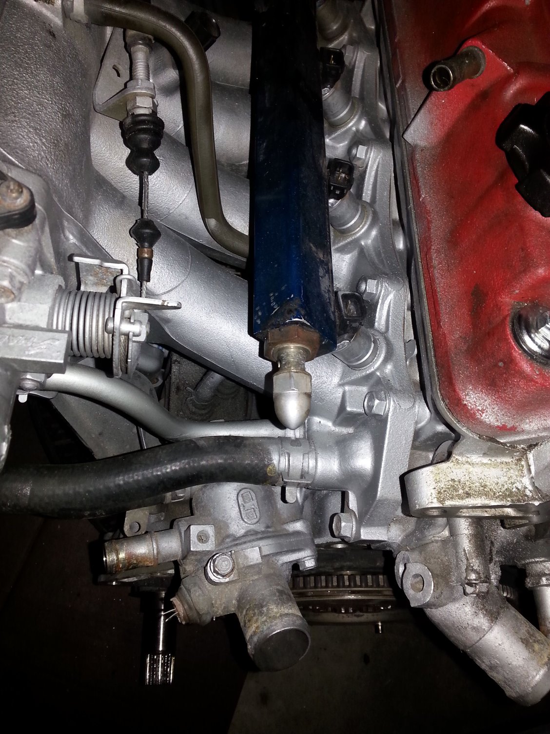

Silver shouldn't be any problem to get off, and should leave no trace behind. Mine had a heavy layer of red under and decent layer of silver. Even after one application you could see the original block following the directions on the can of course. I completely disassembled mine, and repainted afterward, but this first picture should at least give you an understanding of the Aircraft remover's strength. You can see in the second picture red stain remained on my block, so I repainted.
Before:
After:
