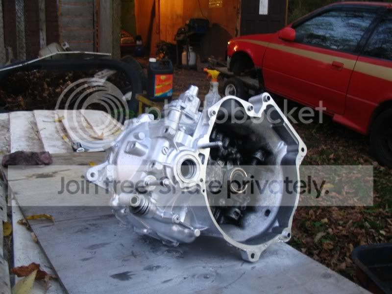

when i did the clutch in the girlfriends car i took the tranny to work degreased it power washed it gave it a dust coat of primer (after a quick scuff with ajax and soapy water with a grey scotch pad) then painted it high heat aluminum color looked like new and pretty bling. that was a year ago and it still looks decent too.
*YES MAKE SURE YOU SEAL THE SHAFT HOLES AND ANYTHING THAT MIGHT SEIZE UP WHEN WASHING IT*
this is my tranny out of my gti swift when i redid it and sold it.
her's looked the same as i did the same thing to the both of them.
