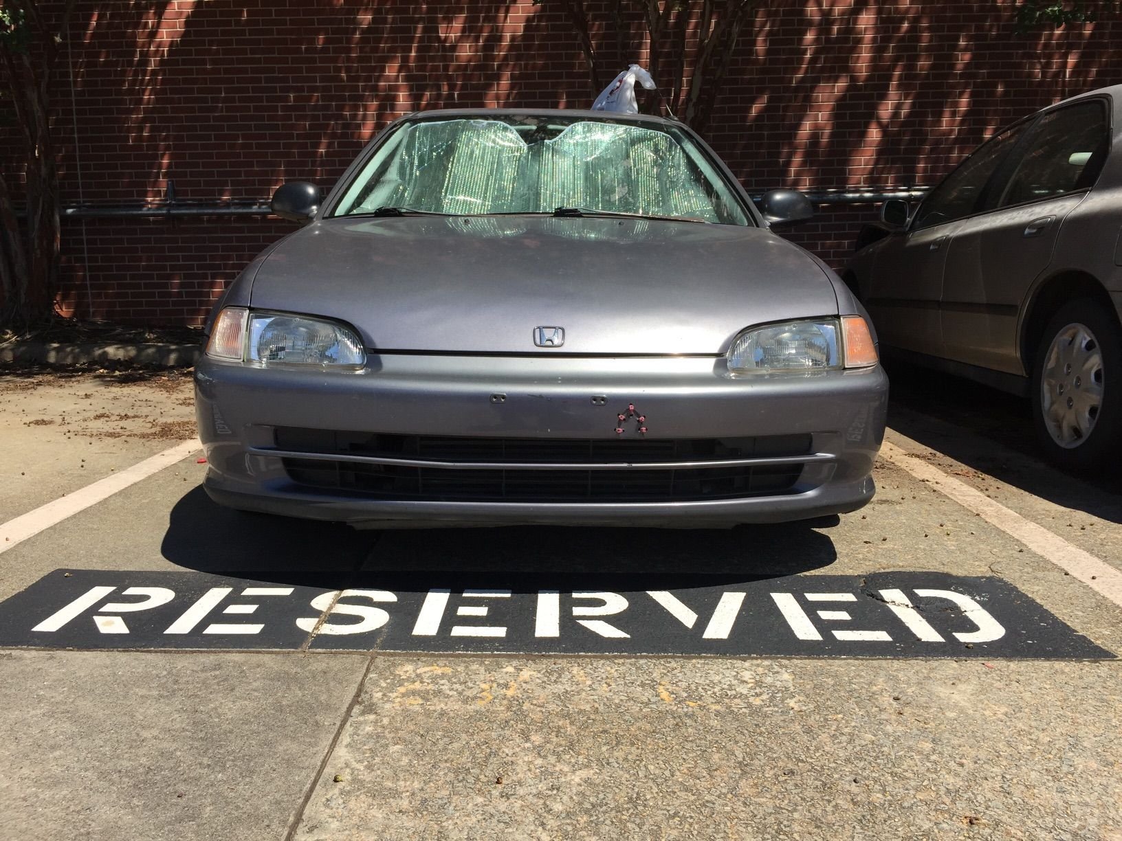

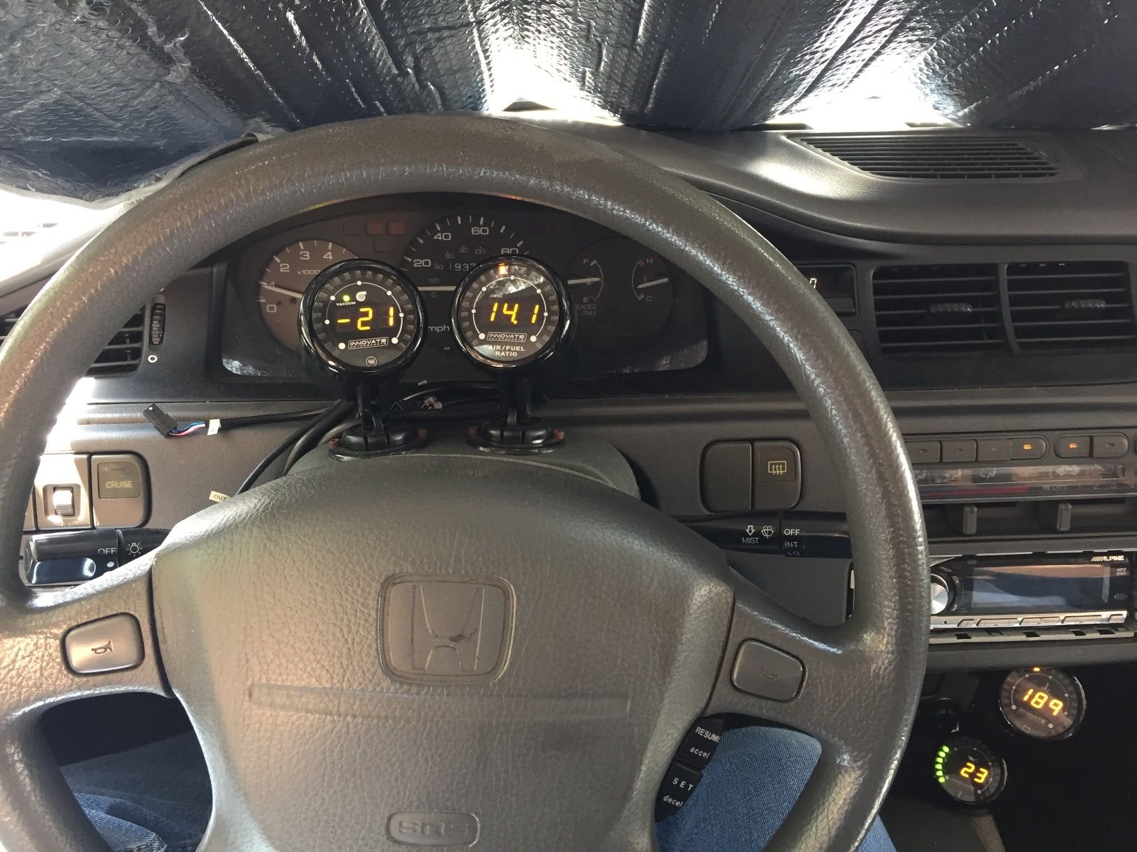

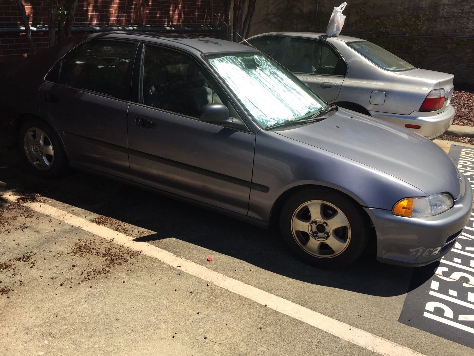

I take a week off from life and devote it only to her. With a borrowed cherry picker and a clean garage, I pull the tired D16 from the Civic and drop her in its place. She's a big girl and she makes for a tight fit, but she fits. I weld the 2.5" collector onto the downpipe and mate it to the Apexi Worldsport II Cat-back exhaust. I loom the Rywire milspec engine harness and plug her in. She fires and idles first turn of the key. I'm so proud of her. After a good idling session, I install the Innovate Dual-Function Digitals and Progress CS II's before taking her to Mony So at Import Xperts in Winder for her first tune. She lays down 302whp and 240ftlbs on the dyno. She's modest though. No pilar mounted gauge pods or flashy wings. You'd never know she was turbocharged unless she told you or you heard me spanking her. She screams loud at wot...
Lately, she's been getting jealous. I saw the new Civic Type R and contemplated selling her for 1, but I've had a change of heart. The new CTR is too flashy for us. Sure, it has working A/C, but she will too in time. Until then, we ride windows down, even in the rain. She likes getting wet. She's my special girl.
