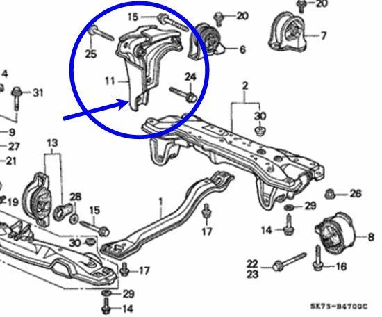

Honda's 95 GSR rear engine mount. The two #23 bolts are 14mm.
I certainly have to use my rear engine mount below. It as 12mm bolts
Hasport has told me I have to drill my mount out to 9/16s inch. The only bolt that's 14mm is labeled 23 above and will be number 24 in the photo below. There are 2 of them in both years, but my engine mount is different, in that the one below is offset and one is much shorter. Honda doesn't list the bottom hole or what goes in it. I've ordered the 14mm bolt, but might have to dig up a shorter one. I'll have to look at the gsr engine to fine out. The two bolts at the bottom mount directly into the engine (trans)....at least on my 90.

I believe you should be using your existing mounts and brackets, no need to drill anything. I may not be correct in this one though.

It depends on the transmission he's using because that's what those bolts go into.

Yes, the y80 hydo that's standard with the GSR of '95. Those two bolts on the y80 are 14mm. On my b18a1 5-speed they are 12mm. That's why Hasport says I have to drill out my mount, but only for those two bolts. The other holes and bolts are 12mm like my existing one.
Really my question is the lowest bolt....Honda does not even list it for my year, but it is there. I went under and looked. The difference in the mounts besides shape is the bottom of the '95 is double thick, maybe an inch and a half apart. My mount is single thickness down at the bottom...compared in the two images, so I'm guessing I'll have to come up with a shorter 14mm bolt. and drill that hole too. I won't know till I get the gsr eng&tranny.

90-91 integra are obd0 and have small spline transmission
92-93 integra are obd1 and have big spline transmission
the changes occured in 92-93 with the updated front bumper, interior, rear tail lights, obd1, large spline trans, etc
i am not aware that honda would change lca or anything like that in 90-91
the only difference that could have possibly been lca wise is an lca without sway bar holes but thats highly unlikely on an integra being that its the sporty model vehicle honda made
your PS pump will be retained along with your crank pulley. the crank pulley needs to be swapped over onto the GSR engine
you will also need an obd0-obd1 wiring conversion and obd0-obd1 ecu jumper for everything to work properly with an obd1 ecu as there are no obd0 gsr ecu
you will have to drill the bottom 2 holes on your T bracket with a 9/16ths drill bit for use on the hydro transmission. the upper bolt will work from the gsr engine but youll need a smaller bolt for the bottom hole
a 14x1.50x35mm bolt and 14mm washer will be needed for the lower bolt hole
