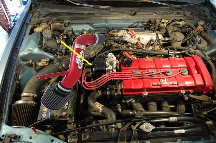

I've run across an issue with the air filter inlet. I've looked at the short rams and cold intakes and none fit. That's no surprise, they're made for specific cars, not swaps.
The short rams put the filter right where my battery is....I'm not interested in moving my battery. The longer, full cold air intakes turn the wrong direction.
I'm wondering about the stock inlet that connects to the throttle body, and some combination of that plus maybe, my current K&N inlet that puts their filter right over the inlet that comes up from under the bumper.
Has anyone done this? Go from the obd1 gsr vtec to the DA? Any suggestion is appreciated.
Thanks!

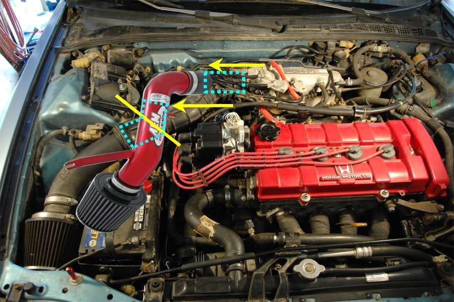

I may take the aem short ram and at their sister company "spectre performance", ....cut the aem and get a piece to turn it in the right direction. Then I could use the K&N front piece that puts the filter directly over the cool air inlet next to the battery. Sounds nuts I know, but I tend to be good at these type of solutions.
Old Aug 8, 2019 | 11:30 AM
1990IntegraLS's Avatar
Joined: Mar 2015
Posts: 875
Likes: 10
Default Re: Swap extras?
I dunno. It seems a little unlikely I could cut this short ram here. What's the hose connection for, a map sensor, or just vacuum? True this photo is not exact, out of scale and the angles are off. I might have more room, I might not. I'm not real positive about doing this, but I'll see how it lines up, after I get the gsr engine in.
Old Aug 8, 2019 | 12:09 PM

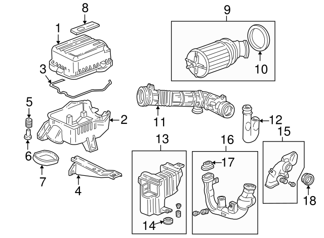

I took a good look at my current flow pipe setup. There seems to be plenty of room to drop it, up to about 2" max. The only place I'd have to change it, is right where the K&N connection is. There's an electrical harness there mounted to the fender well. A 22 degree bend there would probably work.
My '90 flow tube has the fitting for the breather....and two vacuum lines, which would have to be sealed or removed.
but.....from the '95 parts catolog on any Acura site is this below. I have no idea if all of these things are on my engine. HMO states all the water connections are there, but I haven't asked them about the intake connections. My '90 flow pipe does not have these connections and many of these items aren't labeled with part numbers and most discontinued.
I have found the primary pipe, number 11. For $100, but what the heck is 12 and 17?
Old Aug 9, 2019 | 10:44 AM
Caoboy's Avatar
-Intl Steve Krew
Community Influencer
Active Streak: 120 Days
Loved
Posts: 6,932
Likes: 197
Probably resonators or something not needed.
it's not there on aftermarket intakes....you're making this too complicated.
