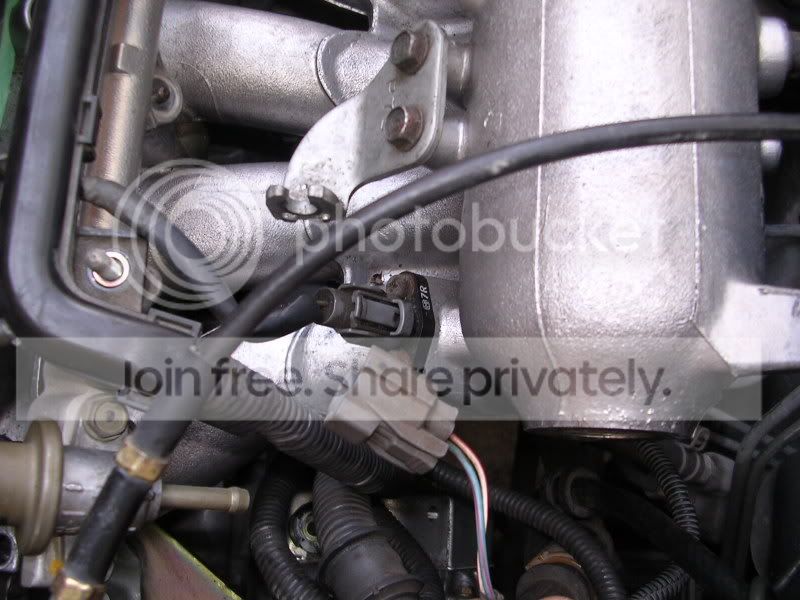

Jason</TD></TR></TABLE>Thanks for that reply... Another question i have is. My B20 is the high CR version 9:6:1 and it has a knock sensor. But, im using an LS harness and they DO NOT have knock sensors... What should i do?
Look here... That first plug i thought went to the knock sensor, but there is no way it could since LS integras DONT have knock sensors it would make sense there wouldnt be a plug for it on the LS harness right?

<TABLE WIDTH="90%" CELLSPACING=0 CELLPADDING=0 ALIGN=CENTER><TR><TD>Quote, originally posted by Blown90hatcH &raquo;</TD></TR><TR><TD CLASS="quote">What ecu are you wanting to run?</TD></TR></TABLE>Im running an Obd2a LS ecu... so it wont even detect the KS....
Can anyone tell me what connector this is??
It also stretches below the intake manifold.. If you look you can see where the wire leads. I dont have any idea where it goes......
