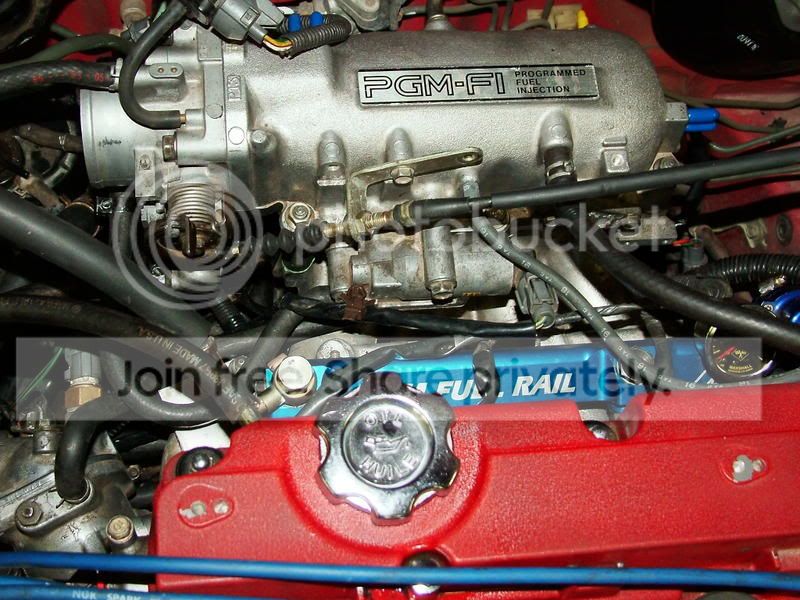

Well my project is finally at the end today but the motor now won't rev past 4k. Is there any suggestions to any kind way to fix this. Please help me guys.

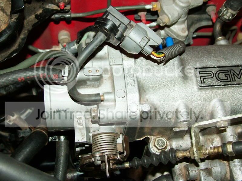

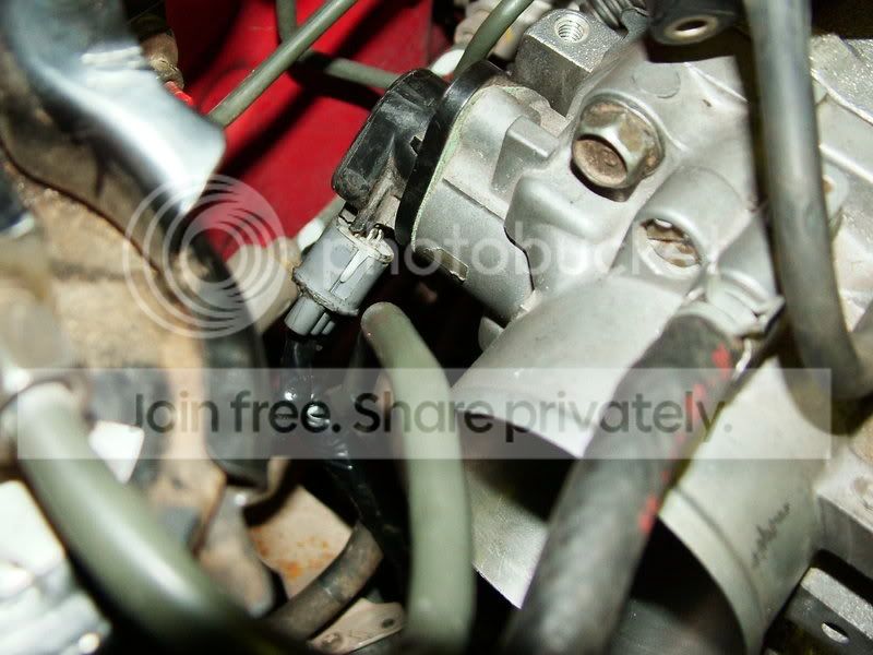

looks like your tps is chipped like a ****, i can see some pins

i changed my tps already it didn't do anything the one i actually got on there is actually good. I know it looks messed up but it is ok.

Your problem is in your first picture,the one with the throttlebody.You have the vss plugged into the tps.you need to find a wiring schematic to wire this thing up properly.the plug for the tps looks like the one for the map sensor.

really? didn't really think that was crossed. Definetly look into that.

that is the tps sensor plug, the previous owner screwed it all up, your right the plug SHOULD look like the map sensor plug, but the dillhole decided to strip the outer aspect of the plug off so that it is just the internal main body so that he could just slip it on. He posted on here just to get some help from peeps that may have run into the same problem. The only reason he said something about an obd1 scanner is the simplicity of it. Not that he can't count the flashes, just that it would be easier to check things out. All he is askin for is some pointers that may be issues, not barkin about counting flashes, or connectors, yadda, yadda, yadda, I've already checked them all out, and they are right.

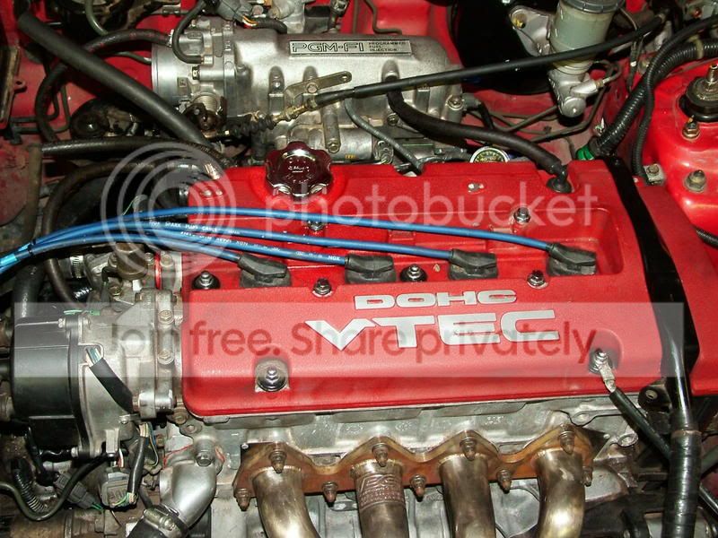

<TABLE WIDTH="90%" CELLSPACING=0 CELLPADDING=0 ALIGN=CENTER><TR><TD>Quote, originally posted by blacktsi &raquo;</TD></TR><TR><TD CLASS="quote">ecu was the problem. Using friends p28 just not compatible because different setup. Just looking for another ecu. Let me know if anyone has one they want to get rid for my setup. </TD></TR></TABLE>a p28 is a p28.if you have the car wired properly you could almost use any 0bd1 ecu to run the car.If you lived here i would have the car running like a top for you.In the pics above it looks like the wiring is your biggest problem.do you still have the stock po6 ecu for the car?put it in and see if it lets you rev over 4k.also what year is the motor?
