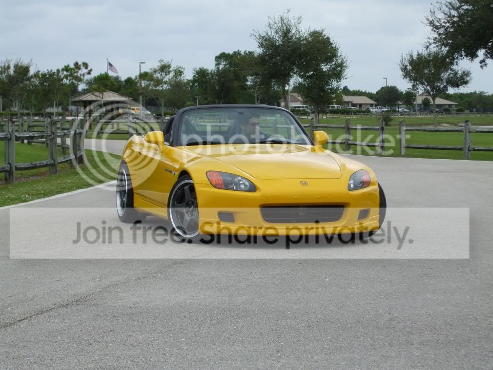

By popular request:
The wheels are SportMax 962's.
FRONT: 18" x 7.5" with a 38mm offset / 215/35/18
REAR: 18" x 8.5" with a 35mm offset / 225/40/18
Rear fenders rolled, rear bumper bolt relocated back, no rub on Eibach Springs.
Front needed no alterations. Perfect clearance, never rubs.
